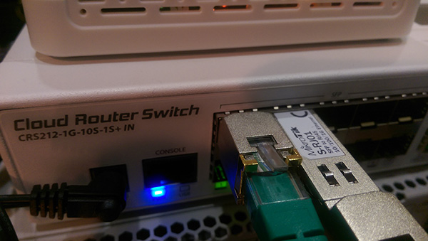

CR212-1G-10S-1S+IN and S-RJ01. Speed problem.

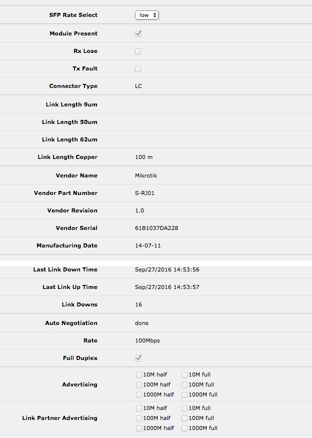

I’ve bought the device CR212-1G-10S-1S+IN and the module S-RJ01, but I can’t make link at speed 1Gb/s. I tried to connect different devices: D-Link 3120, iMac, PC and others, I changed the patch cord - but no matter what I did, the speed when the packets are transferred is 100Mb/s.
Could you help me?

CRS212-1G-10S-1S+ – SFP+1 interface does not work on any other link speed than 10G (does not support 1.25G fiber optic transceivers)
