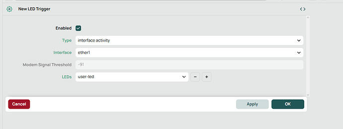

I tried to do something via LED trigger, but I do not understand what “user-led” means, I though there will be option just led-on or led-off.

user led is a separate LED, distinct from ports LEDs. Looking at picture of device (available on product page), it's the LED to the right of power LED and reset button.
