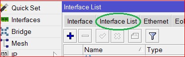

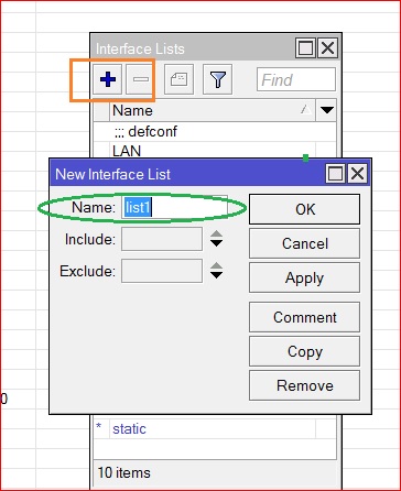

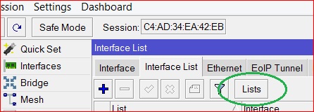

The button with the text “Lists”, on “Interface” / “Interface List”, on the right of “filter” button, do not say nothing to you?
No, that was not obvious…
See, I was blind!
Ta da !!!
