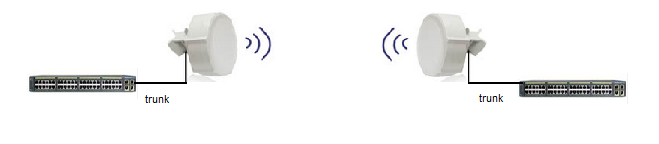

as illustrated attach file, i have a point to point wireless link, and i want create a trunk between cisco switch and Mikrotik Radio for allow to pass several Vlans by Mikrotik Radio.
how can i config radio???

First, create and configure all of your vlans with their corresponding vlan id’s and set the interface to your ethernet port connected to the switch sending the vlan tagged packets. Once you have all of your vlans configured, create a bridge and bridge the vlans and wireless adapter together.
Unless I am forgetting something that should do it!
