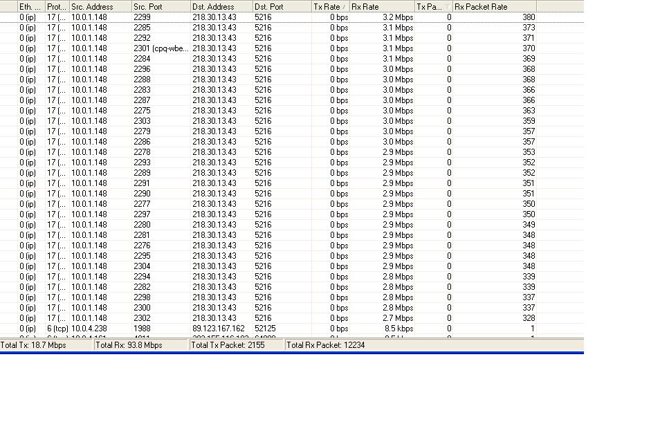

critical issue 98mb flood packets
dear all
this is critical issue my lan interface is block .then i sniff the packets here is detail .
how to block this packets from my lan interface
0 0.26 ether1 10.0.6.253:1377 218.30.20.210:5909 udp 1052
1 0.26 ether1 10.0.6.253:1383 218.30.20.210:5909 udp 1052
2 0.26 ether1 10.0.6.253:1395 218.30.20.210:5909 udp 1052
3 0.26 ether1 10.0.6.253:1372 218.30.20.210:5909 udp 1052
4 0.27 ether1 10.0.6.253:1388 218.30.20.210:5909 udp 1052
5 0.27 ether1 10.0.6.253:1374 218.30.20.210:5909 udp 1052
6 0.27 ether1 10.0.6.253:1376 218.30.20.210:5909 udp 1052
7 0.27 ether1 10.0.6.253:1369 218.30.20.210:5909 udp 1052
8 0.27 ether1 10.0.6.253:1378 218.30.20.210:5909 udp 1052
9 0.27 ether1 10.0.6.253:1385 218.30.20.210:5909 udp 1052
detail
time=4294967.288 src-mac-address=00:08:74:C7:9E:49 dst-mac-address=00:07:E9:0D:F3:CB interface=ether1
src-address=10.0.6.253:1392 dst-address=218.30.20.210:5909 protocol=ip ip-protocol=udp size=1052 ip-packet-size=1052
ip-header-size=20 tos=0 identification=54751 fragment-offset=0 ttl=128
2 time=4294967.288 src-mac-address=00:08:74:C7:9E:49 dst-mac-address=00:07:E9:0D:F3:CB interface=ether1
ip-header-size=20 tos=0 identification=54752 fragment-offset=0 ttl=128
3 time=4294967.288 src-mac-address=00:08:74:C7:9E:49 dst-mac-address=00:07:E9:0D:F3:CB interface=ether1
src-address=10.0.6.253:1374 dst-address=218.30.20.210:5909 protocol=ip ip-protocol=udp size=1052 ip-packet-size=1052
ip-header-size=20 tos=0 identification=54753 fragment-offset=0 ttl=128
raw packets
0 time=4294967.262 src-mac-address=00:08:74:C7:9E:49 dst-mac-address=00:07:E9:0D:F3:CB interface=ether1
data=“4500 041c c786 0000 8011 6f5d 0a00 06fd da1e 14d2 0569 1715 0408 18b0 6161 6161 6161 6161 6161 6161 6161 6161
6161 6161 6161 6161 6161 6161 6161 6161 6161 6161 6161 6161 6161 6161 6161 6161 6161 6161 6161 6161 6161 6161 6161
6161 6161 6161 6161 6161 6161 6161 6161 6161 6161 6161 6161 6161 6161 6161 6161 6161 6161 6161 6161 6161 \00”

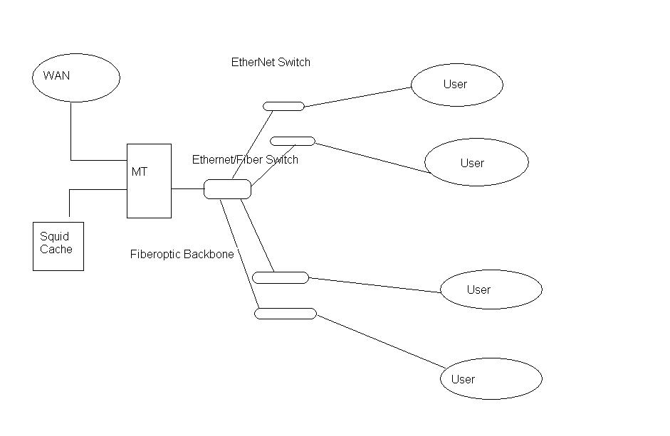

Post the topology of the network.
hi mate
You can’t block UDP from coming into your interface, you only control what’s coming through your router. this has to be done at the switch. If you had the users on different VLANs you could just remove the gw IP address from your router and the packets would have nowhere to travel, but i guess all the users are on the same subnet and you don’t know where to find this particular user? If these switches are manageable you could telnet into them and find the port with 100% utilization and shut it down.
Regards
Henrik
