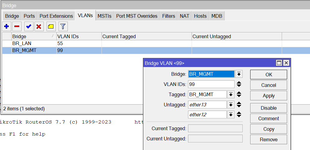

CRR - basic configuration VLAN no DHCP
Mikrotik is new, but I try to do something simple to start.
Simply get an ip in a vlan no filtering.
I tried a vlan attached to a bridge or a simple interface, without success. No lease used.
Is it normal that an untagged/tagged bridge configuration is not visible in the summary table (cf screen) ?
Thanks for your help

For the moment, no particular architecture, I already have a network in place (Fw/pFsense router).
I am in the learning phase of the Mikrotik universe.
I try to understand the basic configuration (Vlan, DHCP etc…)
To summarize, I’m testing with a single machine to get an ip in one of the following networks/vlans tests (no sucess):
Vlan 55 (mode bridge) : eth3 & 4
Vlan 56 (not in bridge) : Ether 6
Vlan 99 (mode bridge) : Eth 12 & 13
Here is my use case, there is nothing else (+ an uplink to a switch, but which is used only when I cut my hand in the tests), not even internet,
it remains only the comprehension of a vlan and DHCP configuration.
When I will have understood how it works, I will think about replacing the pfsense but I’m not there at all
After several attempts, I can not understand why a simple untagged port does not allow to distribute an ip.

problem solved !
Something must have been wrong with the firmware.
A netinstall procedure with downgrade to 7.6 and DHCP is working in 2 minutes.
Thanks anyway for the answers.
