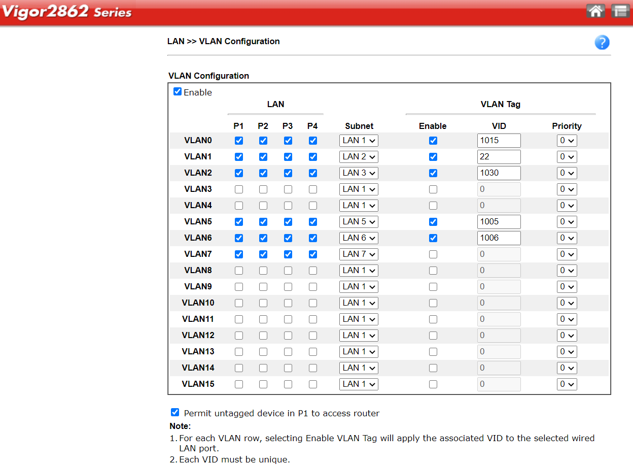

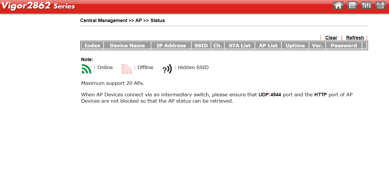

I am also attaching images of the VLAN configuration on the router, and the central AP management section where the APs should appear but do not. You will see that it says there that UDP 4944 most not be blocked on intermediary switches, but I think they are referring to router firewalls, so this is not the problem with the CRS switches.
I am sure it is just a bad configuration somewhere. Hope you may be able to spot something.

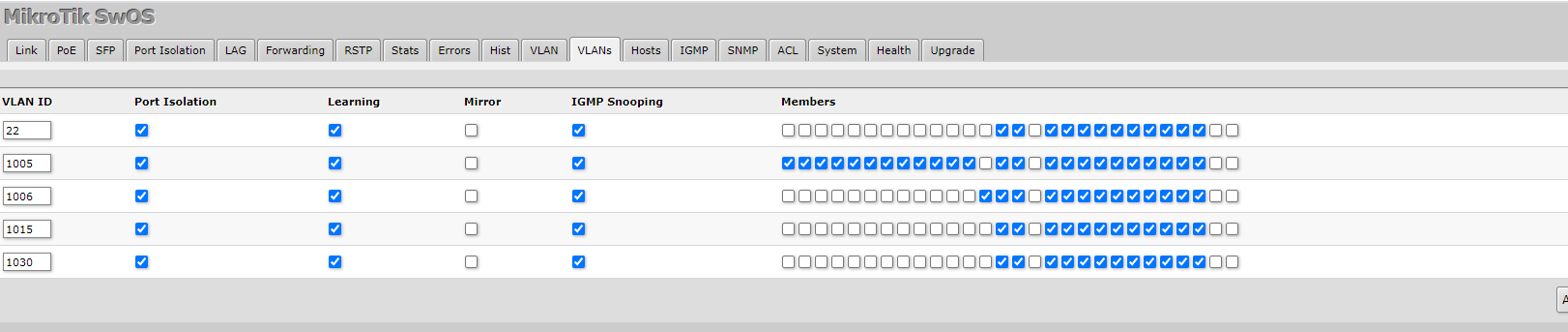

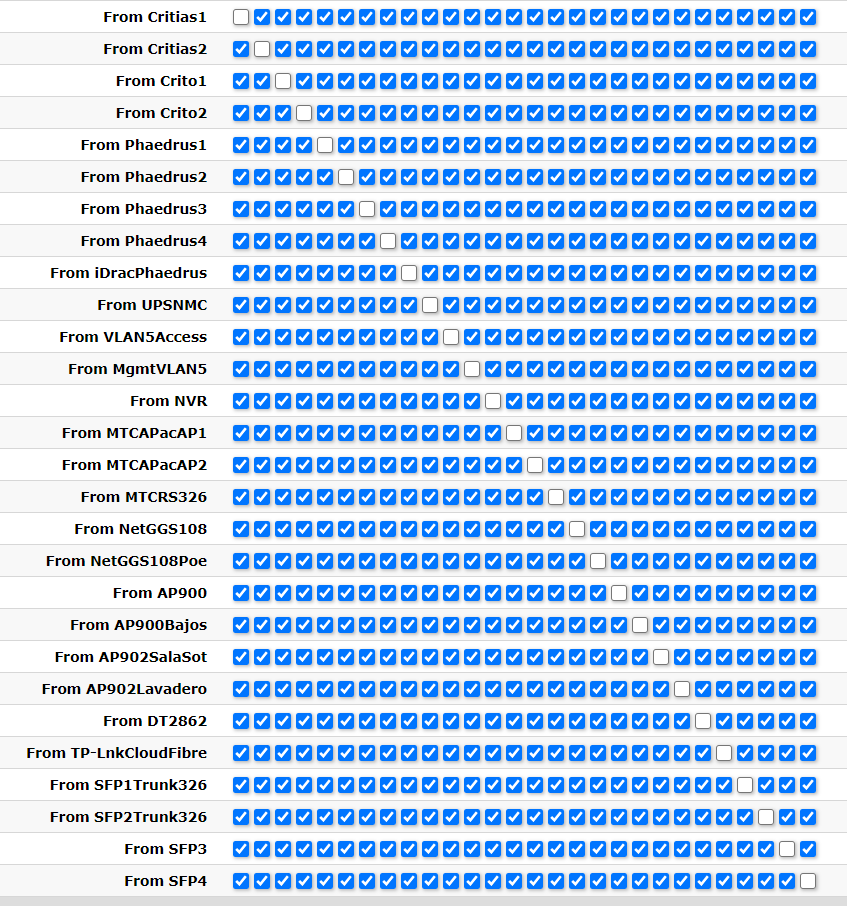

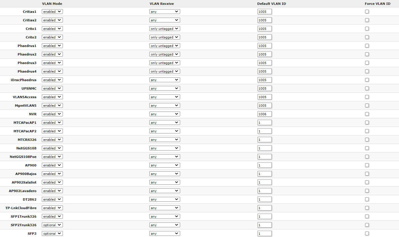

I can’t see any way to export the config on the CRS328 using SwOS. For now I am taking screen grabs of the relevant tabs?. I am attaching them here. Please let me know if you need to see other tabs.
I didn’t fully understand from the manual what effect checking “Port isolation” on the Vlans tab has. I left it checked, although I do not have any port isolation configured. Is it better to uncheck port isolation for each VLAN? I think it might be, as my intention is to separate VLANs using tagging rather than ports.

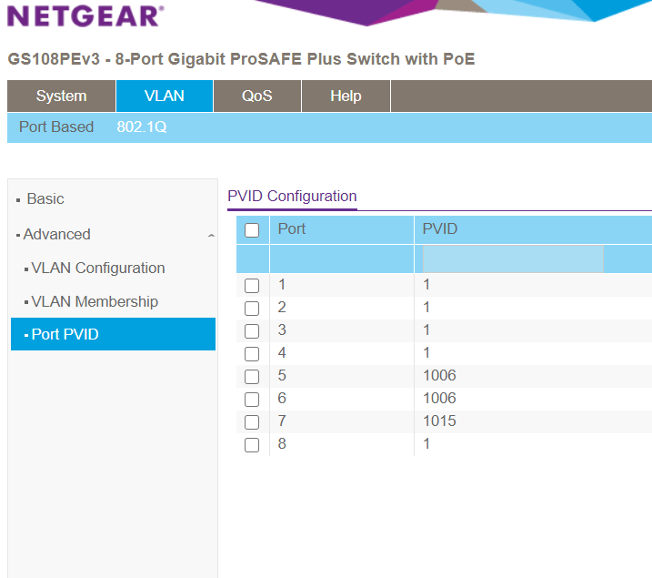

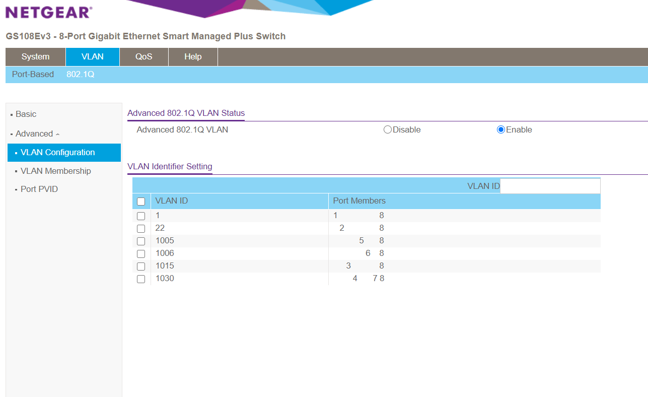

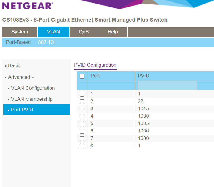

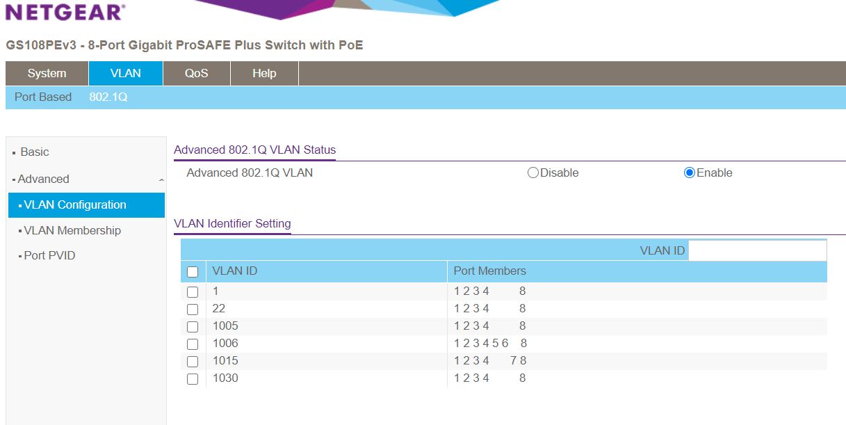

On the Netgear switches (very simple little switches deployed locally close to devices and uplinking to the CRS328) you will see that the ng108P has ports 1,2,3,4 and 8 as trunk ports and 5,6 and 7 as access ports, and the ng108E has ports 1-7 as access ports and port 8 as the trunk.
Now I have discovered something odd which might help diagnose a misconfiguration. As I said, I have set up a Base VLAN (192.168.15.0/24), which I use for management of network devices and so all the devices referred to here have fixed IPs in that subnet. I have just discovered that I can access the management console of the Netgear switches if I connect to the VLAN 1005 (192.168.111.0/24 subnet). That is exactly the opposite of what I was trying to achieve and I don’t understand why it happens.
However, I am still not able to access the Draytek APs’ management console from any subnet and they are still invisible to the Draytek router. I can access the the two MT CAPacs management console from the Base VLAN subnet.
