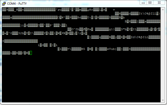

I have a crs125 that I use for testing that I updated to 6.11 a week ago. It has been running fine until today when I wanted to wipe the config and start again. I used winbox to reset the config and checked the no default config box. After the reboot it get’s to the starting services screen on the LCD then reboots. I tried to netboot without success and using putty to console in just shows blocks and a couple unrecognizable characters. Anyone know of a way to load the OS or is this thing bricked?

Tried another baudrate ??
Like:9600
Like:115200
I had it on 9600, figured it wouldn’t connect if it was wrong. I will try it later tonight. Still doesn’t explain the reboots. I did find one other post about this on a RB951 which is also MIPSBE instruction set.

For anyone with this issue, changing the baud rate to 115200 worked
