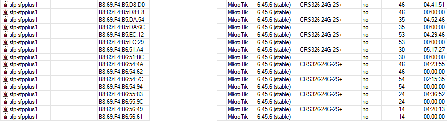

I have several CRS connected with 10G fiber using the default config.
Now every switch is listed twice in IP neighbors: one time with interface MAC and switch model and the second line is the bridge MAC without any additional information and 0 uptime.
Is this a bug or is there a way to hide those entries?

Same issue, suggested solution doesn’t help. Hardware CRS109, CRS125, RB960PGS.
The lists duplicate items always contain the bridge mac address without proper details and the discovery interface mac address with proper details. (just like in the original op post)
