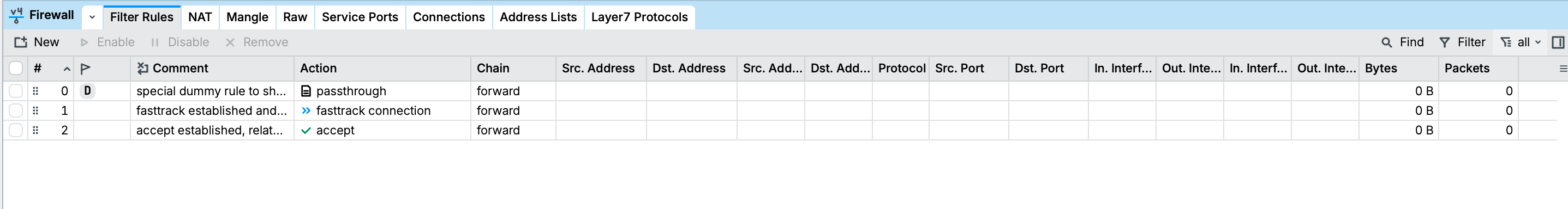

Goal: Firewall traffic from vlan99 to only allow specific host/port access to stuff in vlan100 and offload allowed traffic to get close to line speed.
So I’ve had this in my rack for a while working without issue, but recently I’ve tried to use some of the L3 features to do inter-vlan routing for interfaces on the same bridge. More specifically even with the in/out on the same interfaces. From everything I’ve read this should work but I just can’t seem to get any connections to be fast tracked. With firewall rules in place all processing is done on the cpu and with iperf between vlans I’m only getting ~500mbps. With rules removed and switch ports set with l3-hw-offloading=yesI can get the full line rate at ~9.6gbps.
The counters for the dummy fast track firewall rule have always been empty indicating none of the traffic is being fast tracked. I’ve also rebooted the switch multiple times. Even resorted to updating to the latest 7.x release with no change.

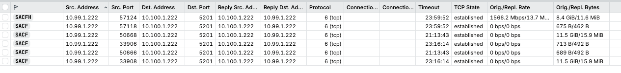

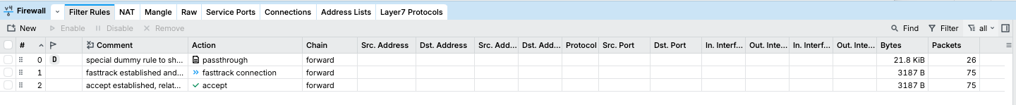

Fasttrack rule lacks setting hw-offload=yes
Must have been leftover from other testing. I updated it to include that
add action=fasttrack-connection chain=forward comment="fasttrack established and related connection states" connection-state=established,related hw-offload=yes
add action=accept chain=forward comment="accept established, related and untracked connection states" connection-state=established,related,untracked
Still have the same results with iperf between vlans of about ~475mbps

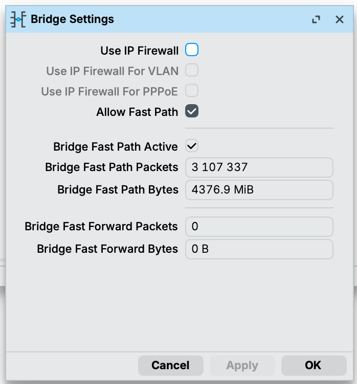

Second, confirm the bridge HW offload setting is actually applied:
[admin@mt-rack-switch-10g] > /interface bridge print detail
Flags: Y - MANAGED; D - DYNAMIC; X - DISABLED, R - RUNNING
 0   R ;;; defconf
       name="bridge" mtu=auto actual-mtu=1500 l2mtu=1584 arp=enabled arp-timeout=auto mac-address=2C:C8:1B:FD:9D:88 protocol-mode=rstp
       fast-forward=yes igmp-snooping=no auto-mac=no admin-mac=2C:C8:1B:FD:9D:88 ageing-time=5m priority=0x8000 max-message-age=20s
       forward-delay=15s transmit-hold-count=6 vlan-filtering=yes ether-type=0x8100 pvid=1 frame-types=admit-all ingress-filtering=no
       dhcp-snooping=no ra-guard=no port-cost-mode=short mvrp=no max-learned-entries=auto mlag-peer-port=none mlag-priority=128
       mlag-heartbeat=5s
Check that hw-offload=yes is shown (not just configured but actually active)
I don’t see it listed here so maybe I’m hitting a condition where it’s not enabled? To be honest I feel like I’ve read conflicting into on what to enable and not at this point. I only see hw offload settings on the switch.
If you are below 7.14, update first and retest before changing anything else
I was previously on 7.16 and upgraded to latest 7.22.1when I couldn’t get it working. Figured I’d try the latest version when I too read there were issues with previous versions.

Does the fasttrack rule work when you disable L3HW on the switch menu /interface/ethernet/switch/set 0 l3-hw-offloading=no?
Didn't seem to do anything at least with rule counters

Summary
So I think in summary it's working as intended? I naively thought at least regarding firewall rules that if applied on the ingress interface (vlan99 for me) that I could just restrict it and leave every other vlan devices unchanged (ie: using the existing router gateway). The output with switch ports set to l3-hw-offloading=yes is what gave me this impression. Maybe this is just a quirk with the firewall and connection tracking I'm not really sure.
aside: when switching the switch ports l3-hw-offloading from no to yes or vice versa you can see the active transfer throughput change if an existing iperf test is running to a device that doesn't use the switch as its gateway.
root@test-vlan99:~# iperf3 -c 10.100.1.42
Connecting to host 10.100.1.42, port 5201
[  5] local 10.99.1.222 port 59794 connected to 10.100.1.42 port 5201
[ ID] Interval           Transfer     Bitrate         Retr  Cwnd
[  5]   0.00-1.00   sec  56.0 MBytes   469 Mbits/sec   15    281 KBytes
[  5]   1.00-2.00   sec  54.4 MBytes   456 Mbits/sec    9    329 KBytes
[  5]   2.00-3.00   sec  54.4 MBytes   456 Mbits/sec    1    349 KBytes
[  5]   3.00-4.00   sec  53.8 MBytes   451 Mbits/sec    5    301 KBytes
[  5]   4.00-5.00   sec  54.4 MBytes   456 Mbits/sec  107    226 KBytes
[  5]   5.00-6.00   sec  1.01 GBytes  8.69 Gbits/sec  136   1.21 MBytes
[  5]   6.00-7.00   sec  1.09 GBytes  9.38 Gbits/sec    0   1.45 MBytes
[  5]   7.00-8.00   sec  1.09 GBytes  9.39 Gbits/sec    3   1.47 MBytes
[  5]   8.00-9.00   sec  1.09 GBytes  9.38 Gbits/sec    0   1.48 MBytes
[  5]   9.00-10.00  sec  1.09 GBytes  9.38 Gbits/sec    0   1.49 MBytes
[  5]   0.00-10.00  sec  5.65 GBytes  4.85 Gbits/sec  276            sender
[  5]   0.00-10.00  sec  5.64 GBytes  4.85 Gbits/sec                  receiver
@EdPa I do appreciate your response and testing too.
This.
When a connection is initiated through one gateway and the return traffic flows through another (asymmetric routing), it never reaches the established state on the CRS317. As a result, the firewall fasttrack rule counter always stays 0 (unrelated to L3HW).
You could ditch the connection-state=established,related,untracked and fasttrack/offload the traffic anyway, but that defeats the purpose of the stateful firewall. A more optimal way would be to keep L3HW enabled on all switch ports, and use switch ACL rules for the stateless firewall via /interface/ethernet/switch/rule, which by the way, operates at line rate.
Alternatively, you could use the CRS317 as the gateway for your VLAN networks.
