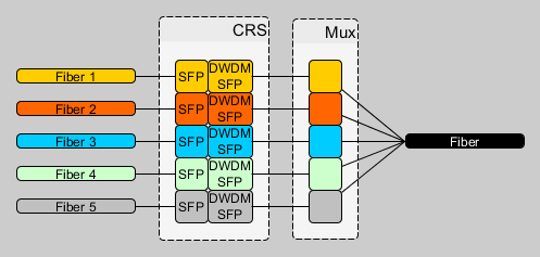

I would like to use a CCRS212-1G-10S-1S+IN to convert SFP to DWDM SFP without affecting the traffic including VLANs, cost and DSCP (just like 5 unmanaged switchs 2 ports unmanaged) and I think the best way to do this would be via QinQ, to add a S-VLAN on one port and remove it on the other.

Here a schema to understand better.
