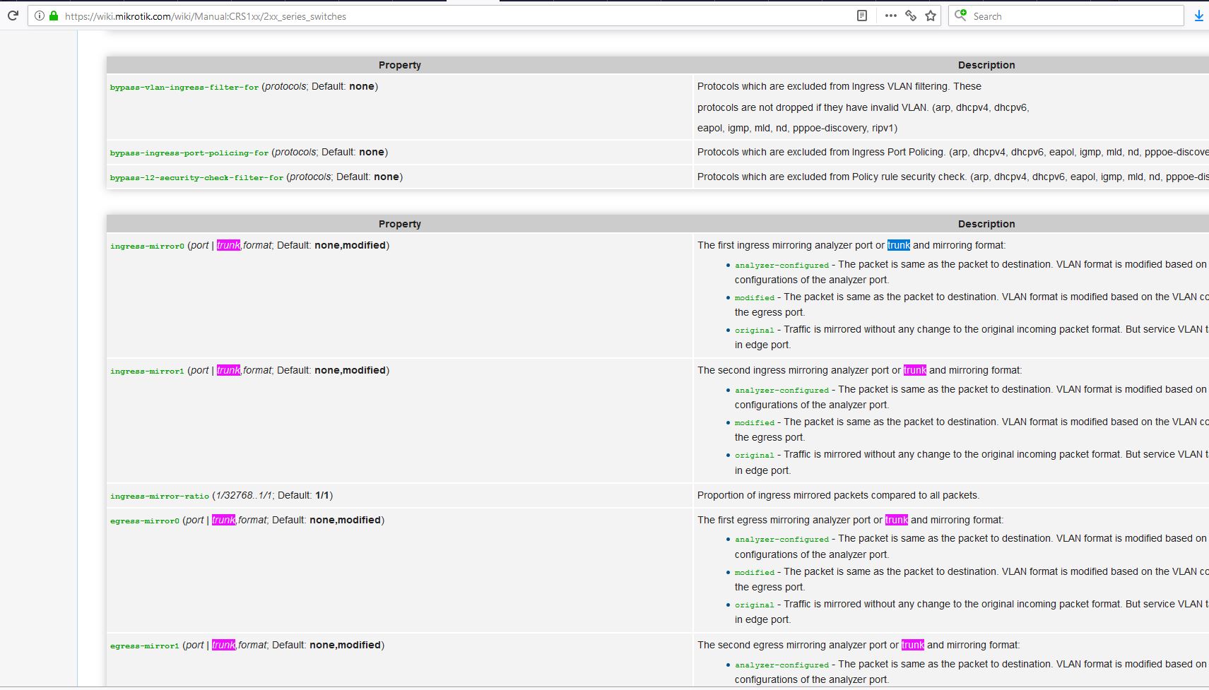

I want to send 4 Gigabit to my analyzer server. I created
/interface ethernet switch trunk
add member-ports=ether8,ether9,ether10,ether11 name=trunk-8-9-10-11
According to documentation https://wiki.mikrotik.com/wiki/Manual:CRS1xx/2xx_series_switches it is possible to use trunk as mirror destination
ingress-mirror0 (port | > trunk> ,format; Default: none,modified)
egress-mirror0 (port | > trunk> ,format; Default: none,modified)
Also in winbox and terminal I can see the trunk port and it is in port list but after choosing it and apply , following failure message appears.
failure: port  does not belong to switch1
Note that after the port there is a blank space . Winbox shows following error.
Any help appreciated.
