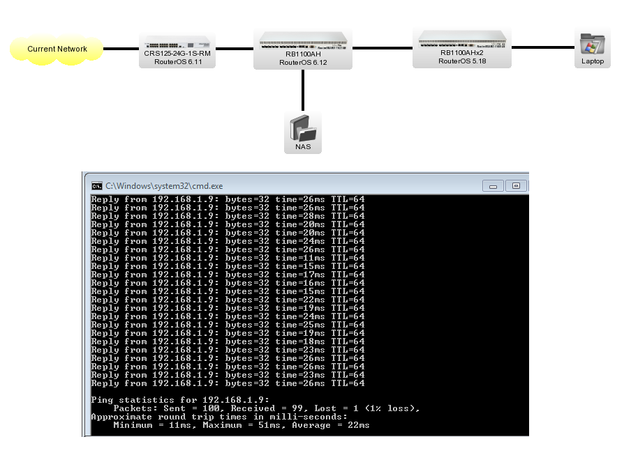

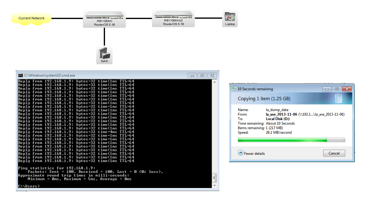

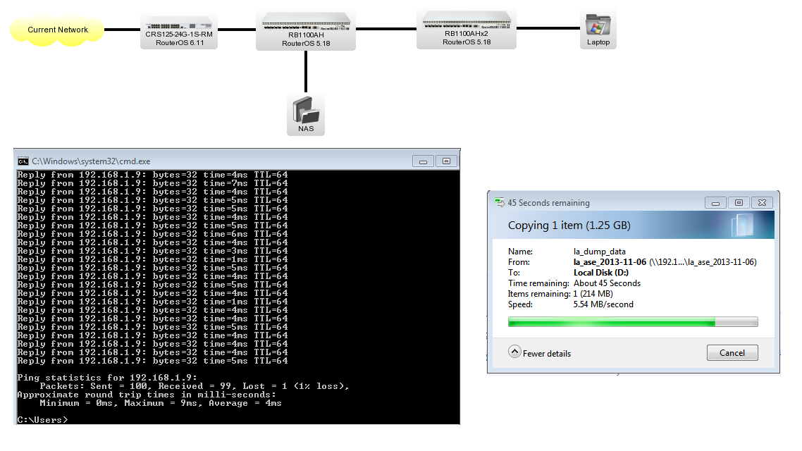

Case Test With Current Network.
  1. All network plug into Gbit ethernet.
  2. Ping Test to Live DB Server.
  3. Copy Test into NAS.
~ Current Network Speed.
~ With CRS125 on network. we have packet loss even on small network.
~ ROS ver 6.x ruin everything. Bad Ping. DB connectivity not working.
