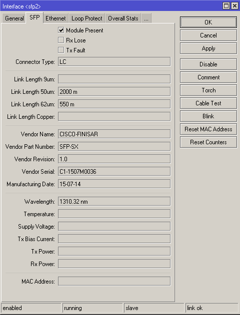

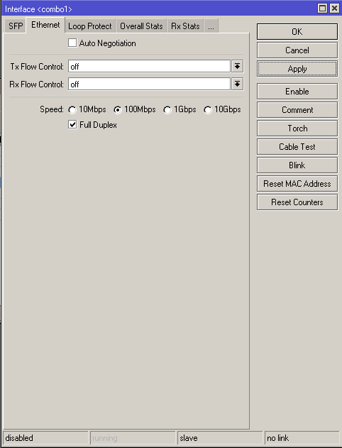

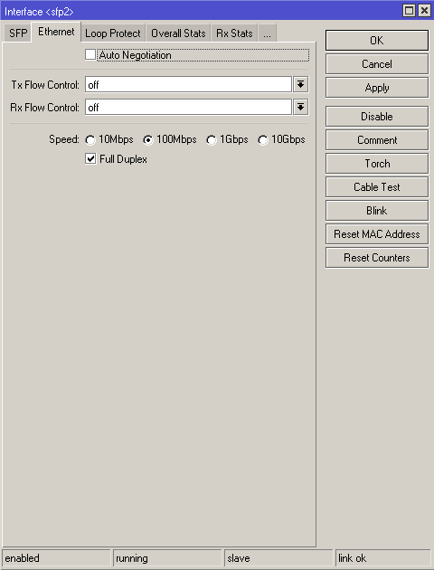

I tried to connect two CRS106-1C-5S devices through 100 Mbps LC MM 1310nm SFP module (100BASE-FX).
First try was with sfp2 port and second with combo-sfp.
Also I tried to connect it with other device through fiber interface same as above.

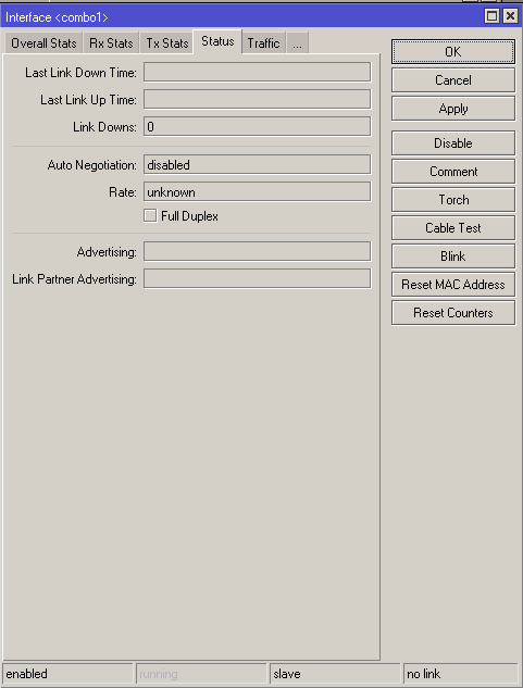

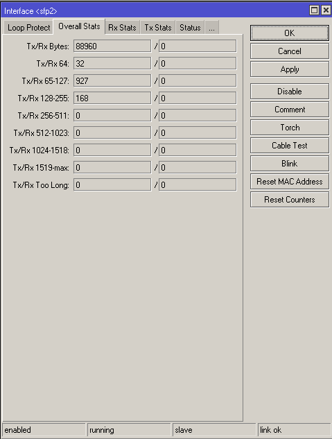

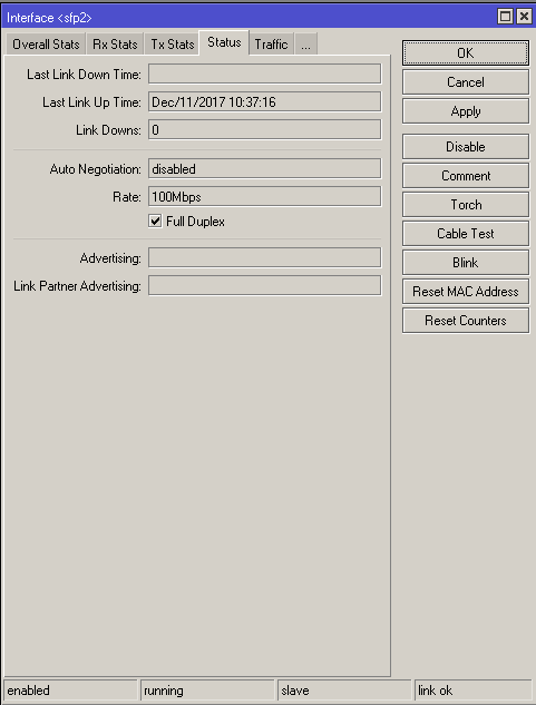

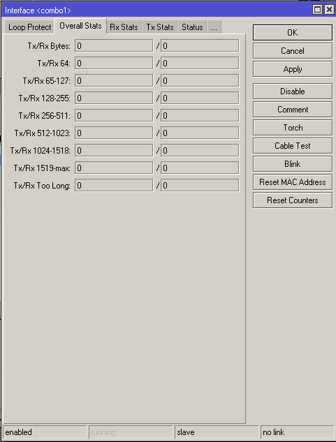

Connection didn’t work. Through sfp2 port link was up, but only TX counters increased, no data was received though. Through combo-sfp2 I couldn’t even make a link up.
Screenshots attached
