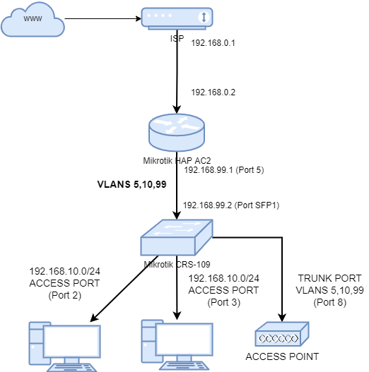

I’m trying to implement a basic VLAN configuration with:
  • A Mikrotik HAP AC2 as a router, DHCP server (switch chip Atheros 8327) (config attached)
  • A Mikrotik CRS-109 as managed switch (config attached)
VLANS:
  • VLAN 5: It will be used for Access Point that is connected to Mikrotik CRS-109 (192.168.5.0/24)
  • VLAN 10: It will be used for every PC wired connected to CRS-109 (192.168.10.0/24)
  • VLAN 99: It will be used as managed network (192.168.99.0/24)
Mikrotik HAP AC2:
  • Connects to ISP router/modem, and with a dynamic IP address (192.168.0.2/24)
  • Creates 3 VLANS and provides a dynamic IP to every of them (as DHCP server).
  • Connects to managed switch through a trunk port and send the three VLANS (55,10,99) through port 5
  • For VLANS, I’m using switch chip (Atheros 8327)
Mikrotik CRS-109:
  • It receives the 3 VLANS (5,10,99) through port SFP1. This port (SFP1) is configured as Trunk Port
  • Ports 2 and 3 are configured as Access Ports for VLAN 10 (192.168.10.0/24)
  • Port 8 is configured as Trunk Port to send to an Access Point (VLANS 5,10)
  • It’s also using switch chip
What is working?
  • Access point is connected to port 8 from CRS109 and receives every VLAN and is working great (trunk port)
  • A Windows PC is connected to port 2 from CRS109 (access port), receives an IP address from VLAN 10, and have internet
  • A Linux PC (Raspberry PI) is connected to port 3 from CRS109 (access port), and receives an IP address from VLAN10

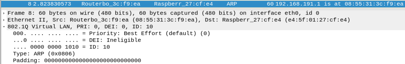

  • Linux PC (Raspberry PI) connected to port 2 from CRS109 (access port), DOES NOT ping gateway and DOES NOT have internet connection
  • When I sniff ARP in Linux PC, I see that VLAN 10 seems to be tagged (802.1Q ID=10) (snapshot attached)

  • I tried to use “Eg. VLAN Translation” from CRS-109 → still receives tagged info
/interface ethernet switch egress-vlan-translation
add customer-vid=10 new-customer-vid=0 ports=ether2,ether3,ether4
