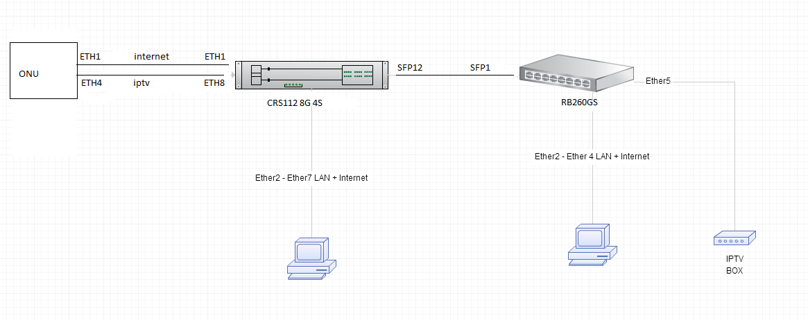

I have a big problem, with my new CRS. I can’t find a clue. I have ONU from my IPTV and internet. It has 4 ports. 1gbit is for internet and 3 others for IPTV.
I had to sent a signal with internet and IPTV using my old RB260GS. I had connection like this:
IPTV signal from my ONU wired to port 1 of 260GS and internet signal to port 2 of 260gs. Them 3 oher ports worked like a switch. On port of IPTV I set VLAN 20 and send it to SFP port, and the rest i create VLAN1 where was internet. On Second RB260gs I did this same but on 2 ports where IPTV for STB and 3 other ports for Internet.
Now I removed RB260GS from basement and put new CRS112 with 4 SFP ports. How can I do that same on it: The second RB260gs still will be working getting signal of IPTV and internet on his SFP port. But now I want to use 1 of SFP port of CRS to communicate with RB260gs. I need for example use eth8 port to connect IPTV signal from onu and send it to SFP12 with VLAN 20 tag to the RB260gs. And rest of ports eth1-eth7 works like a switch with intrnet. And still I need to send this internet to SFP12 on VLAD ID 1 to RB260gs. And of course ITPV signal and Internet had to be separate.
Please if anyone can help me with this.
http://forum.mikrotik.com/download/file.php?mode=view&id=26025
