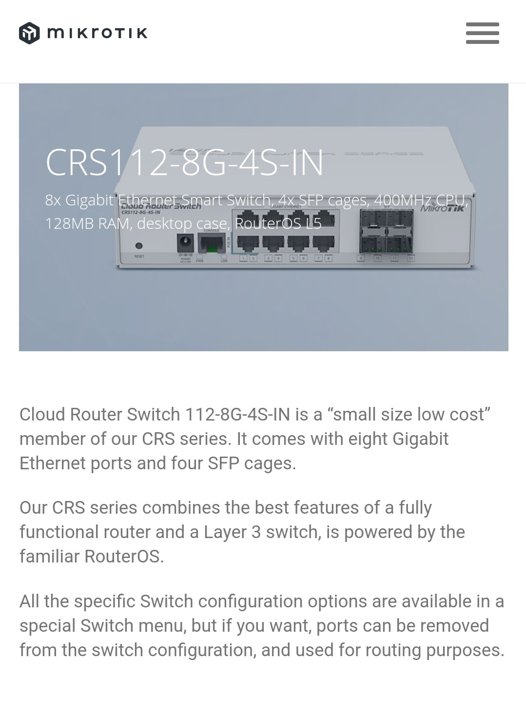

Don’t… That device is not meant to be a router…
Hello.
Really? Eventhough it says it can work as a router?
Basicly i want to separate my network from other network whic would be NATed for access.
I was thinking I could use this model as separator and have 3 VLANs for second network on it. Traffic will be small and slow. I can provide with network diagram, if it will clear things. I really am stuck…
Thank you.
It can work but it won’t work well. What are you using now as router ?
It can work as a router, but performance is below mediocre. Look at official test results. Even in most optimistic interpretation it can’t route at more than a few hundred Mbps. Reslistic real-life performance estimate is number, listed as “routing - 25 ip filter rules - 512 bytes”, for your device it’s mere 30Mbps.
