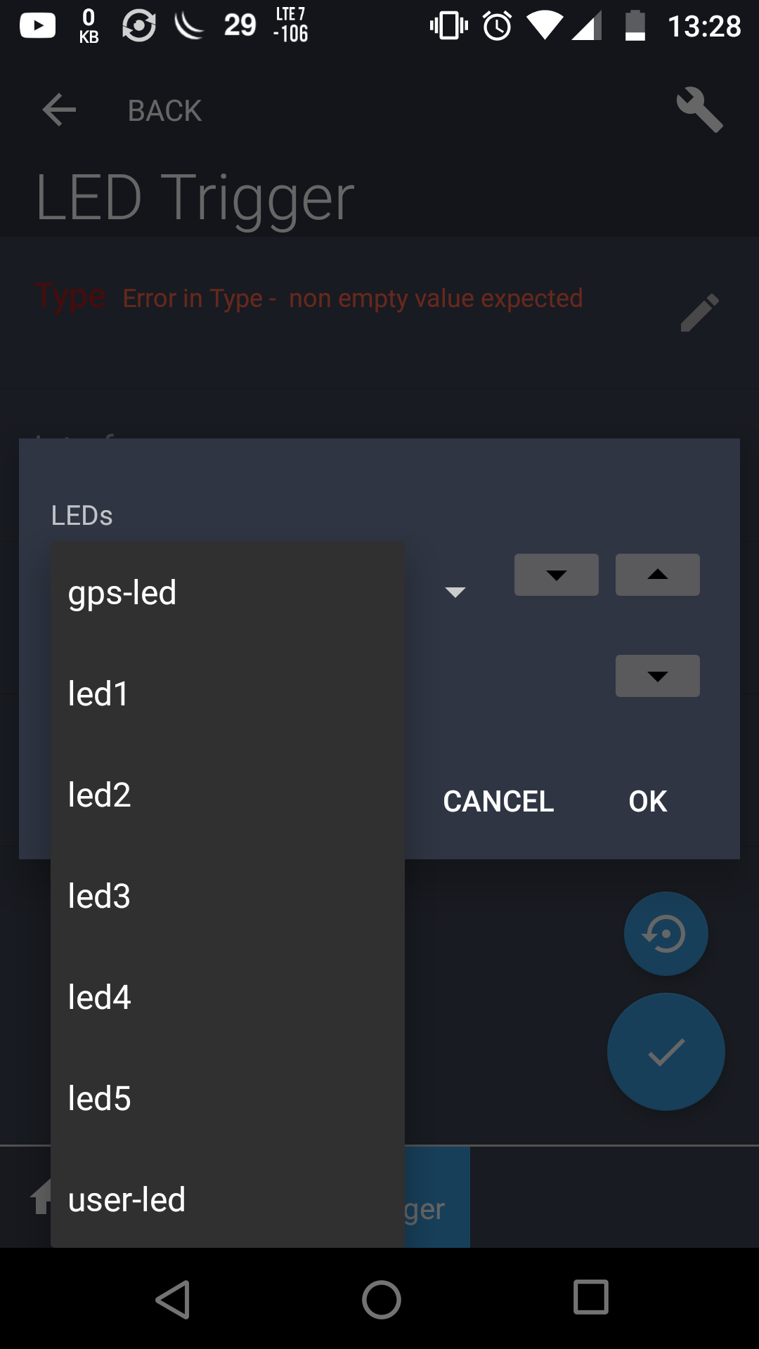

Show what LEDs you can control under Systems → LEDs
I attach an example of my LtAP.
Regards
