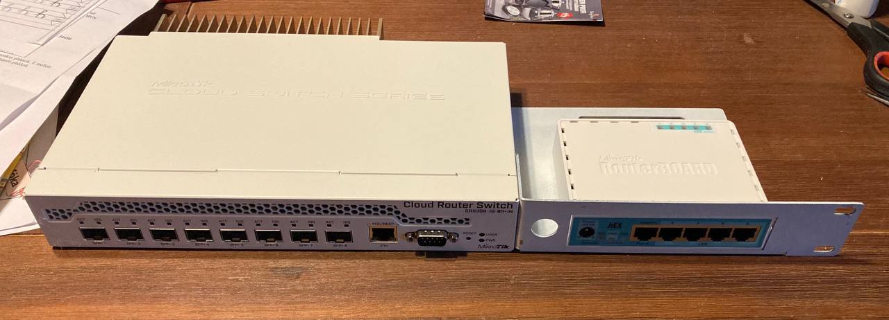

Sorry for reviving old topic but I was also searching for dual rackmount for two CRS112 as I needed to mount another CRS112 and was out of space.
In the end I just had to improvise and make my own - took those long brackets from both units, cut them and placed another piece of aluminium as back support (could use rest of the bracket but I used another piece). Secured with screws
Excuse the craftsmanship as I am electrical engineer and have just a $5 hacksaw, some leftover bag of screws and nuts (but hey, they are stainless :sunglasses: ), handheld drill and screwdriver that was not perfect fit for those screws. But I am pretty proud of this :smiley:
First I screwed those brackets to both units and then joined those two brackets together. The separation between those 2 units is sufficient for a quite easy access to those nuts.
