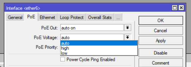

From what I understood, if you use both sources simultaneously (28V and 48V), the switch should supply the equipment with the required voltage depending on the type of PoE: passive or active.
It has a field where you can set the voltage to: Auto, Low or High.
Normis can confirm whether it is so or not.
You can select the poe out voltage between low and high, for 24V and 48V..
