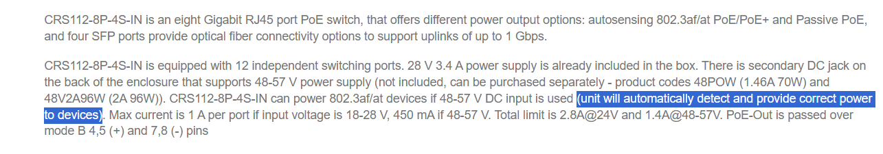

I have a CRS112-8P-4S that is already powering three '“regular” at/af devices with the 48V PSU
When I want to power a Hex Refresh device, I get an error saying ‘detected poe-out status: low_voltage_too_low
Is it normal that a passive PoE device like the Hex refresh doesn’t negotiate it’s power or that I can’t change the port settings on the CRS112 to act like a passive PoE port ?
The page https://help.mikrotik.com/docs/spaces/UM/pages/17498209/CRS112-8P-4S-IN doesn’t state otherwise :frowning:
Powering the Hex refresh with the included 28V PSU works just fine.

Interesting. So I could power it with the second 28V power adapter and that could provide the “passive” power to the Hex ? Second option would be to use a PoE injector. I’ll try both options later.
That’s why I thought providing both at/af and passive PoE would work with the single 48V PSU. But it doesn’t. Perhaps the sentence “unit will automatically detect and provide correct power to devices” only pertains to the at/af ones.
PS: my electrical knowledge is limited (read: non-existing), so perhaps that’s why I made the wrong assumption.
In any case, I put in a PoE injector. All working fine now.

I agree that the wording could be clearer (if many people are confused by this, please don’t hesitate to put in a support request for clarifying the docs - they usually do it, just not with a high priority) The wording is indeed very literal: it applies to power (Watts), not to voltage (Volts).
The CRS112-8P-4S has two power inputs — one for high voltage (48-57V) and one for low voltage (18-28V). It does not convert voltage internally, but simply passes through what’s supplied.
To power 24V passive PoE devices like the hEX, you need to connect a 24V PSU. The switch will then automatically detect and provide the correct voltage per port, as long as both 24V and 48V PSUs are connected.
So yes, the statement about automatic detection is correct — but only when both power supplies are used. No injector is needed.
