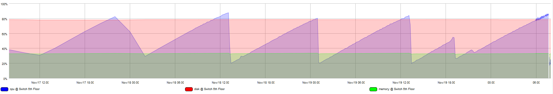

i install couple of brand new crs112-8p-4s came with ros 6.48.6 and upgraded to 7.12.
the configuration quite simple, that are tagged 3 vlan on vlans and egres vlan translation tab. other configuration are powered cycle if ping failure, dhcp-client, ntp-client, romon.
but.. the cpu of all of the switch act the strange behaviour that always reach to 100% usages from time to time. currently i put script to reboot the switch if the cpu reach 90%
here is the graps of the cpu usages from last three days
see the blue one (cpu)
and here is the configuration :

i have another configuration with the same type of switch and with the same configuration, just upgraded to 7.12 and they are not act the same behaviour. it means, if was configured with 6.48.6 and than upgraded to 7.12
can anyone see the problem source ?
thank you
My guess: it’s your “test-script” setting (it’s very probably needless). According to netwatch docs, the netwatch service itself already does ping test by default and test-script property defines additional test to be run after the probe (simple ICMP by default) already finishes.
Since /ping command runs indefinitely by default and netwatch doesn’t stop test-script forcefully, I’m guessing that your CRS starts a new ping every 15 minutes (netwatch interval setting). Since ROS needs some CPU cycles to process that ping command and after a while there will be a number of ping commands running, it will overwhelm the modest MIPSBE CPU in your device.

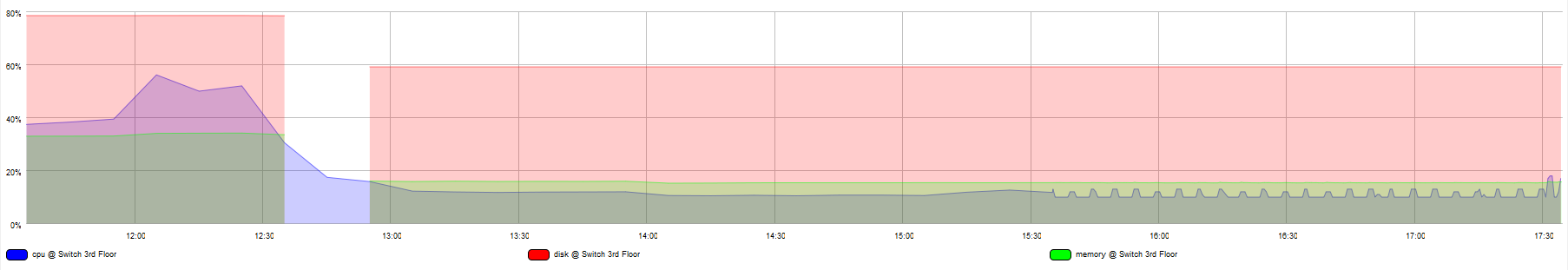

hi all,
down grade to the last long-term; ros 6.49.10 seems solve the problem; no changes on the configuration of switches.
i did downgrade it at 12 noon and now the graph of cpu usage seems to be stable

hi,
the problem start before that mentioned script made. i made that script to prevent the router unaccessible due to cpu reach 100% and could not ping to anywhere (with result time-out).

i dont see too much benefit upgrading this Old Switches to V7, i hope you dont need to use some V7 feature on that devices
well, i do has port security / mac-address filter problem on v6 at the other site and it has been solve when upgraded into 7.12. but… they do not have the same strange memory behaviour. their cpu memory stay low as if they are still on v6
EDIT: the problem seems to be solved after upgrade to 7.12.1. we will see if port security / mac filter address issued exist on this version
