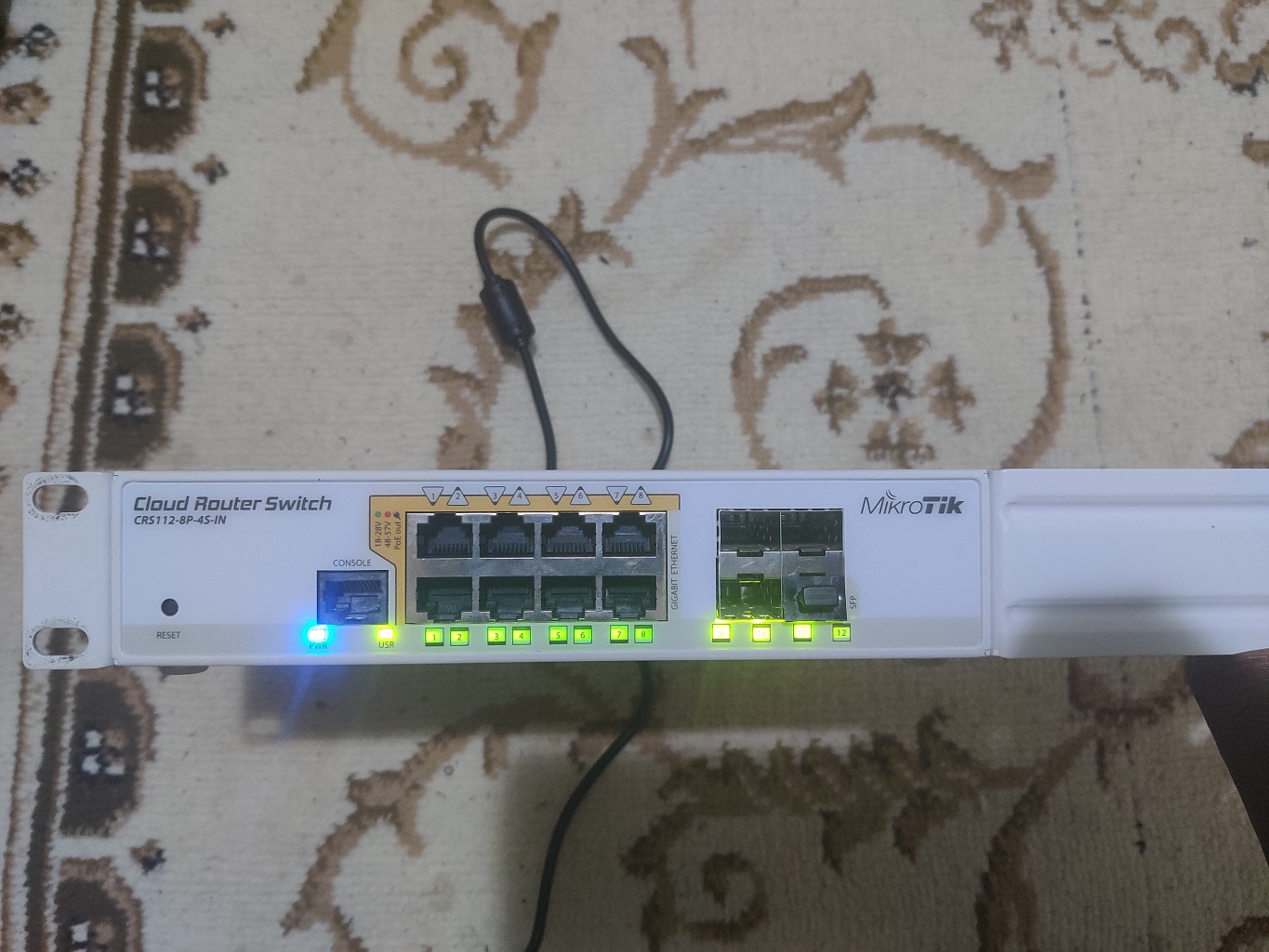

So got a CRS112-8P-4S recently, setup 6 passive PoE devices, UBNT Rocket prisms. Everything was working fine for like a month. One day I come and find 3 of the ports blinking red on the PoE LEDs. and the devices connected don’t respond, thought the switch was reachable. So I decided to reboot. The switch h went off then on again with all, but the PoE LEDs on. Please see the picture below. I have tried accessing it via the console port, but nothing is coming up on putty, and yes my console cable works. tested on cisco switch.
Is there something I am missing? Or is the switch dead?
PS: I have tried a replacement power supply

That unfortunally looks like it’s stuck in bootup. Maybe it’s possible to netinstall, maybe not.
The PoE leds is the top row. Bottom row is link/activity.
The console has no output whatsoever, just blank
I tried this, but the ethernet ports don’t seem to come up
Meaning it's dead??
yes :(( i hafve one in same state after storm
can’t boot on any way, bios is dead, console do not display anything and reset key are useless
Sad news, nothing to do. If it is on warranty, apply RMA.
Regards.
Gues it’s gone. Thank you for the feedback
