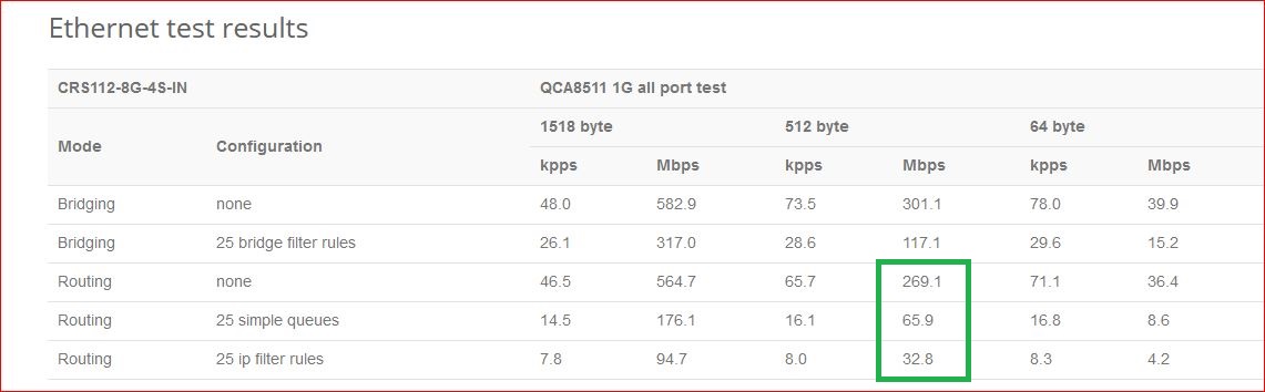

https://mikrotik.com/product/CRS112-8G-4S-IN#fndtn-testresults
Depending on your config ~30Mbps is probably to be expected.
The device only has a 400MHz Mips cpu, so it won’t be able to do much on the routing side.

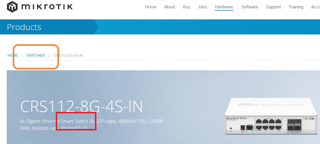

Well, it’s a switch. As you can see in the in the post above, and it’s listed as a switch on mikrotik’s official web site.
There is no need to supply it with swOS as you can use it as a managed switch with Router OS. I have several devices that I use like that, for eg. L009 and few of hexS.
If you need great performance then you need to chech CCR lineup of devices.

For that you should ask Mikrotik, but this device is clearly in switch section and performance is clearly stated here.
I mean if you look at CPU used here you can see that that device is not meant to be used as router but as a switch.
