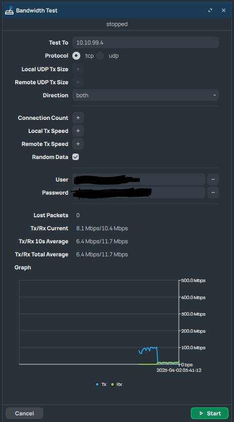

CRS112 Slow speed (10Mbps) on Layer2 switching with SFP
I just got a crs112 switch for Layer2 switching and I connected it to a crs309 via sfp.
I turned auto-negotiation off and set manual speed to both switches to 1Gpbs. I am using an official mikrotik DAC the XS+DA0003.
I have a mgmt vlan 99 on the bridge and tagged on both the bridge and the spf port
It seams strange because it is exactly the same config as any other of my switches.
Despite the config I have done I get megabit speeds or even lower.
Any ideas ?
ps. I know that it does not support HW offloading but I expected at least some kind of performance not this slow

Instead of using vlan filtering, you should configure vlan on the switch menu.
https://help.mikrotik.com/docs/spaces/ROS/pages/103841836/CRS1xx+2xx+series+switches+examples
[ babling ]
Ohhh of course … how I missed that.
Thank you very much.
Q:
Since I have never tried this way will it work seamlessly with router on a stick setup ?
Sure, no problem.
Perfect, thank you a lot
