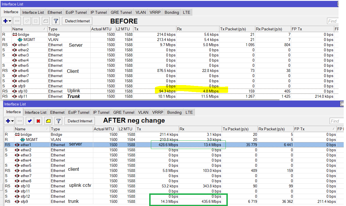

I noticed file transfers were quite a bit slower for some reason. I checked the switch interfaces and tx/rx speeds were about 10Mbps through the trunk and server ports. Was seeing about 500K transfer speed.
When I went to set the router interface (ether2 on HAP ac2) to 1Gb no negotiation, and the same on the switch sfp interface, (1G non negotiate) the router and switch no longer moved traffic - zero on stats. So I changed them back, then tried rebooting the switch and router to hard set the trunk ports to 1Gb non-negotiate, and just won’t connect. I did set negotiation back on, and set to only advertise 1Gb full, on both sides. Attached shows the before and after stats, seeing about 430Mbps now, and a file transfer ~40Mbps. Is this the ‘wire speed’ limit for these smaller switches? I set it up with no settings in the beginning, maybe my mistake, as I thought they would all just negotiate what is best.
I may try rolling back to my original config, (with no interface settings) but so far it’s acceptable. I don’t know what changed, has been running great for over a month (since March been running solid) with the help of the forums here.
Host on ether1 is a Linux 18.04 server set to 1Gb full.

I wound up setting ALL interfaces to 1Gb-full, with negotiation disabled. Everthing runs fine like that, even though the wiki suggests not to disable it.
