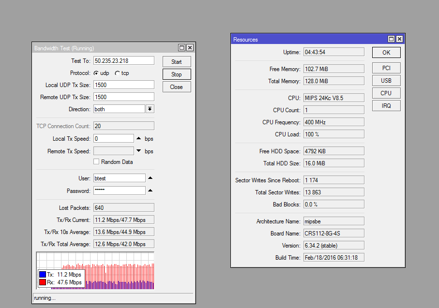

Unfortunately, I have problem with network speed. On Mikrotik I’m reaching max 30/20 Mbit/s network speed of 200/20 what I have from my main ISP (checked with Speedtest.net). When I connect main uplink directly to my laptop - speed is ok and I’m using full network bandwidth. ether1 and all connected to bridge devices are linked with 1Gig speed.

Ok, I probably know the reason… CPU is too weak to use it as a router :confused:

Had you checked your CPU usage? Try checking your system resource while doing a speedtest @ ookla and see if it’s a CPU bottleneck. Of course, if your cpu reach 100%, maybe it’s something that’s using all your box, so we can check up your NAT rules and etc…
