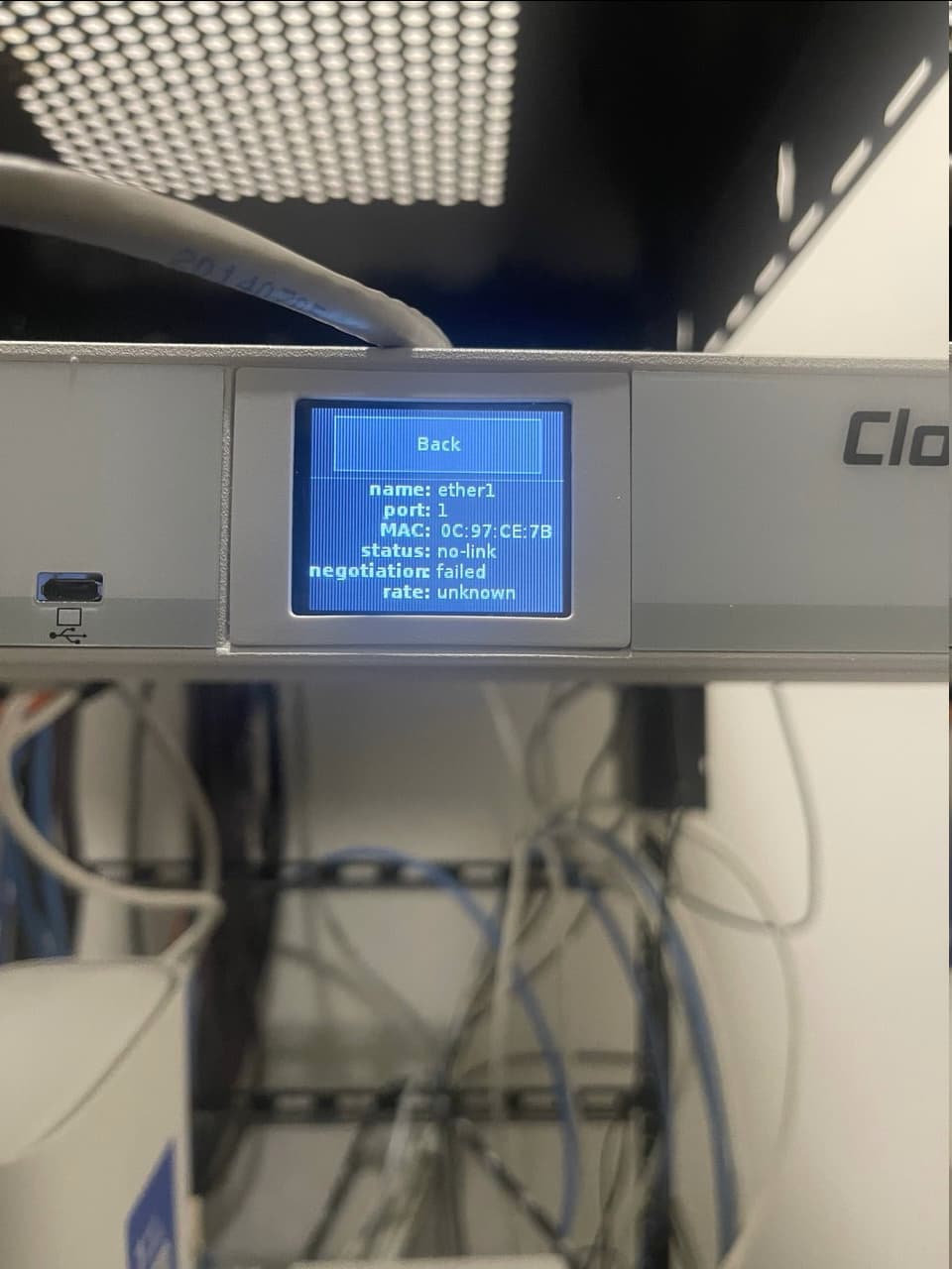

I am having trouble with the above named switch/router. A couple of times per hour, it beeps once, turns off the ports, the display says it’s downloading something, beeps twice and turns back on. This process takes about 15 seconds and then everything goes back to normal.

I don’t even know where to find the answers to your questions. I found the info in this photo from the small display.

Info is saying that ether1 connection broke. Either due to something device connected to that port is doing (power off) or some problems with connection (cable get damaged, port got damaged).

Sounds like reboot. RB beeps once on power-up and twice after it completes loading ROS.
You need to pull up logs to check for crashes. If nothings there, look for power faults - bad supply, overload etc. CRS125 has console port so logging that to computer or another RB can help in case logs are empty.
