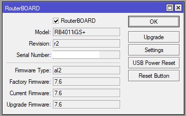

indeed Latest shipment of rb4011 comes with v7 preinstalled

The CRS125 was always slow as a router. It’s because the CPU is a AR9344 (single core IIRC) coupled with a dumb L2 switch chip. The CRS3xx series (except those who use SwOS) use Marvell Prestera switch chipset that is able to accelerate L3 Switching in hardware. As for RB4011, it is not a “RouterOS v6” device, it is simply a hardware box that can use whatever OS you put in… So i manage many RB4011 that are now using RoS v7 with no problem at all. RB4011 has an Annapurna Alpine AL21400 CPU coupled to a Realtek RTL8367SB which doesn’t support L3 switching.
