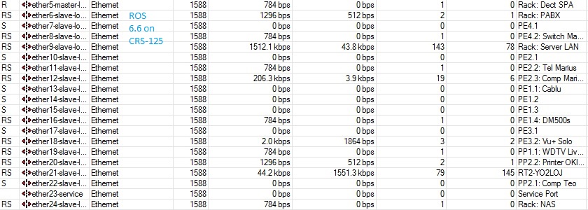

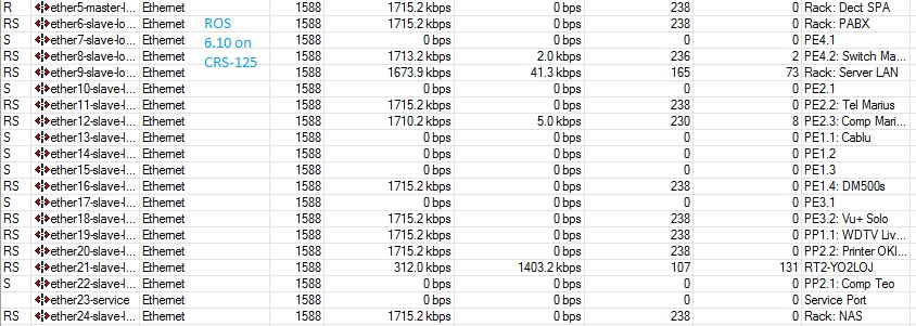

Let me show you!
The same traffic from 2 video streams, nothing more…
And it is not only the picture. The traffic is visible via sniffers.

First the correct picture:
And then 6.10:
