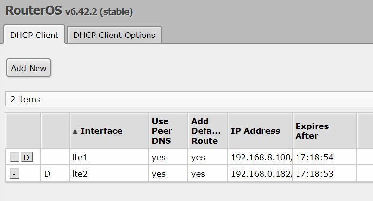

Thanks you for your reply, Upower3.
When connecting both LTE modems via the USB HUB the Mikrotik is detecting them automatically and is adding the following DHCP client entries.
According to my knowledge they look alright.

What’s amazes me is two lte interfaces and two IP addresses. If you have only one modem then it is strange. Take a note not to mess with same subnet on different interfaces (192.168.0.x/24 use to be wildely used around).
At the moment that I was taking the screenshot two LTE modems (one ZTE MF823 and one Huawei E3372) were connected via the USB HUB.
During configuring I removed the ZTE LTE modem. (The ZTE one has less antenna gain, so I prefer the Huawei)

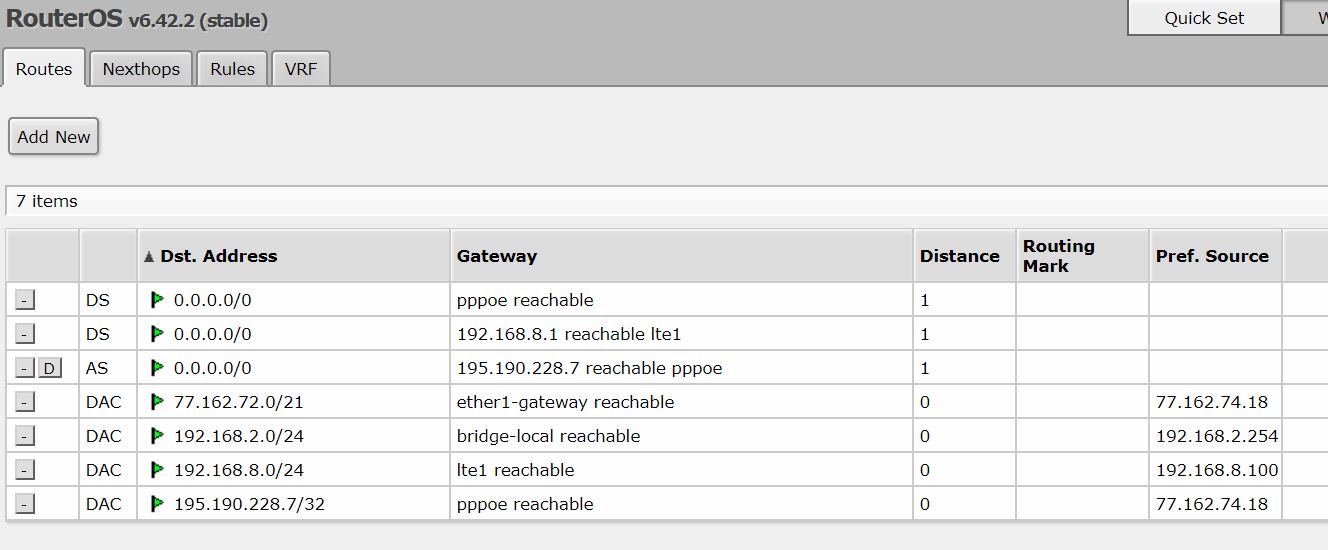

Erik, maybe you need to disable others routes for test and leave only one lte?
check my dynamic routes, they have some different than your
10.88.0.1 - my MK ip (default gateway on my network)
192.168.8.1 - lte modem
192.168.8.100 - ip given by modem`s dhcp to MK usb port

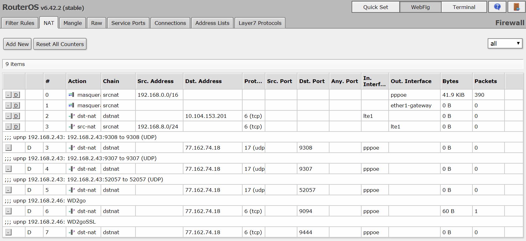

When I am trying to add NAT, I see that a few entries are automatically made by UPnP (Universal Plug and Play) equipment This normally makes intelligent connections between two pieces of UPnP-equipment possible on port-level. They normally can exchange the IP-addresses used and have dynamic access to the internet.
I have switched on the UPnP at the Huawei E3372 modem, however it doesn’t add any NAT in the list.
More settings on the Huawei LTE modem are not available.
Will the network mask 192.168.0.0 /16 also take the range 192.168.8.0?
How does the Mikrotik read its configuration? First line first or more precise line first?

usually you need to set masquarade NAT rule for new interface to access inet

My current routes are as follows:
According my knowledge this should be OK.

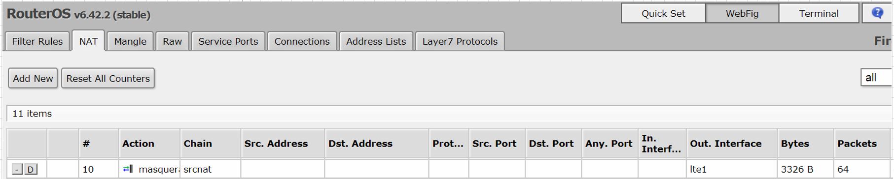

Erik, i think you need to set NAT masquarade rule to access net through new lte connection
I have added the NAT masquerade rule and I can now reach the GUI of the Huawei modem at 192.168.8.1 using the browser.
i think all will be ok now with you
