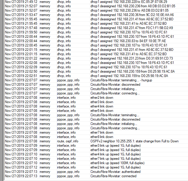

Any update on this? I have the same thing happening, only the ports that have active connections show in the log “link down” then 2 seconds later "“link up”

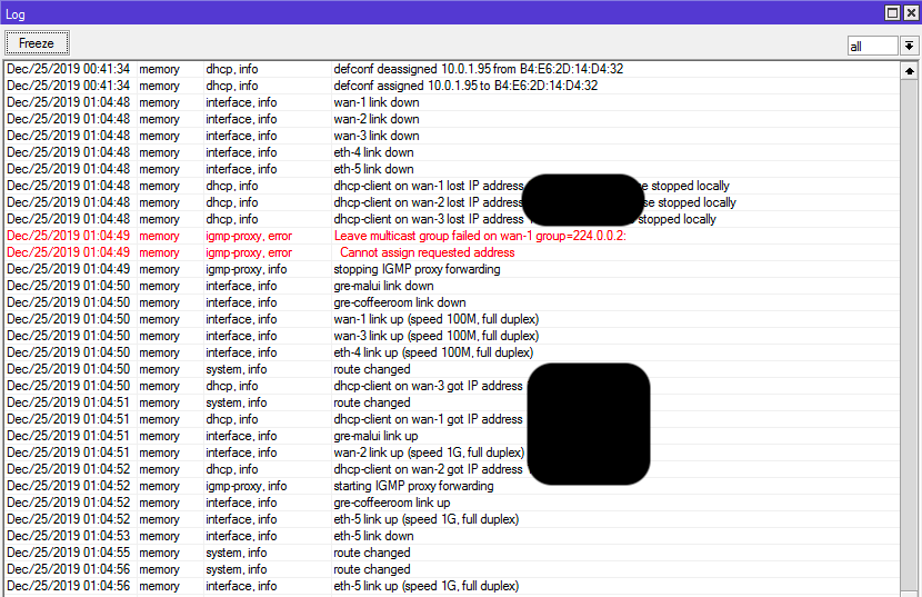

same to me on a CCR…

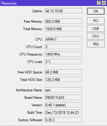

Same thing on my RB3011UiAS, it happens one-twice a day. Any solution?

I’ve seen this on my CCR 1009, All ports go down, system does not log a reboot.
