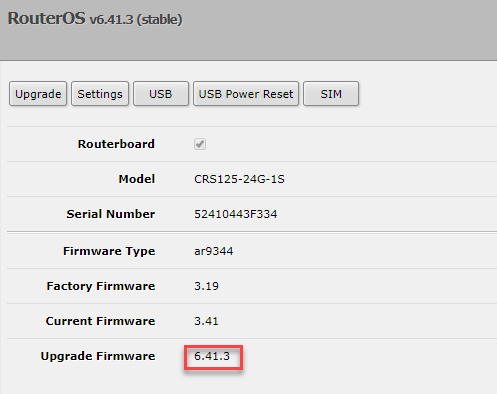

I have a CRS125-24G-1S which I just updated to Routerboard firmware 3.41 and then RouterOS 6.41.3.
The System–>Routerboard menu is now saying that there is a new firmware version “6.41.3” available. This sounds highly suspicious and incorrect.
Can I get someone to confirm if there really is a 6.41.3 firmware now?
Since recently, firmware version numbers are same as ROS version numbers, so it’s normal that after ROS upgrade there’s firmware upgrade with same version number.
Beware: there are reports that on certain hardware firmware 6.41.3 does not boot ROS and that in such case firmware has to be downgraded. Browse through forum posts to see if your RB is affected as well.
