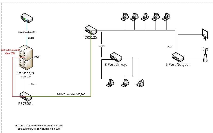

I have some Question about Routing and Vlan.
There is my Network at Home. :wink:
I need to build a trunk between the RB750GL and the CRS125. But I need full wirespeed on the VLAN 100 because of my Fileserver on the ESXi. The Firewall (VLAN 200) need to be routet on the CRS125.(about 30Mbit) This can go through the CPU.
My Question is this possible? I dont understand whow tho splitt Vlan over the Switch Chip (VLAN 100) and the CPU (VLAN 200) :wink:
Maybe someone can explain that to me.

I need full wirespeed to the File Server ,-)
today I got my 750GL and a 951G-2HnD :wink:
I still have problem to build 2 Vlan. One Vlan (VLAN 200) must be routet for the Internet and on the other Vlan (VLAN 100) I need full wirespeed.
