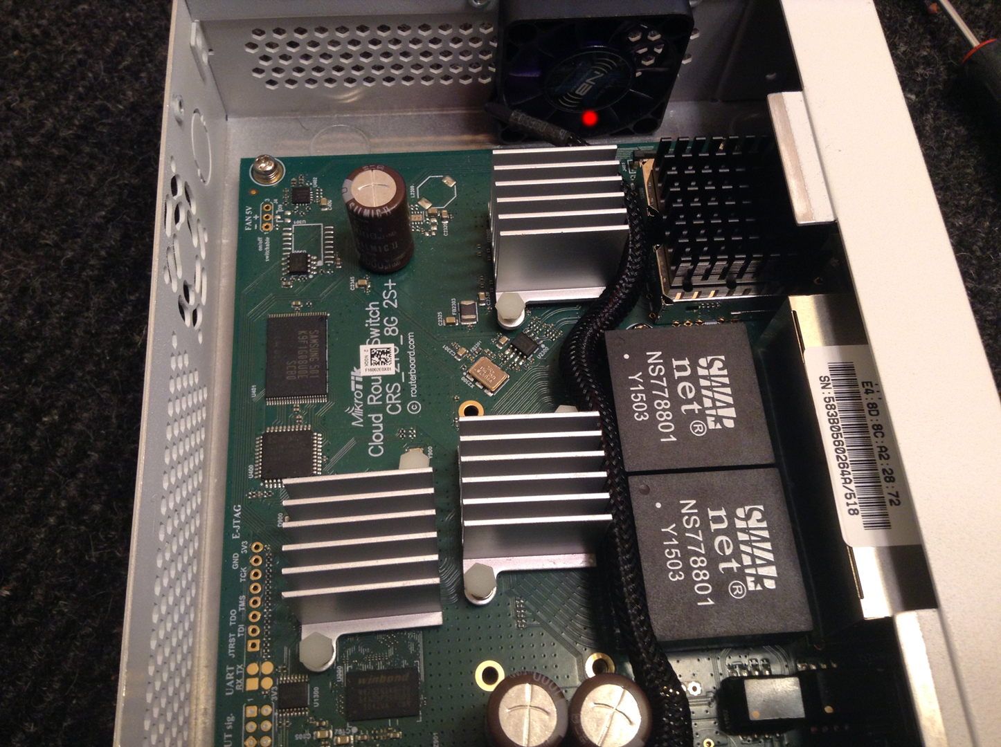

I love this switch. Ive done some additional hardware work to it for some special purposes. While doing some hardware reengineering I noticed a serious issue.
So… There is a place for a fan on the CRS210-8G-2S+IN. In fact there is a board connector location for a fan - unpopulated.
If you put 1 SFP and 1 SFP+ 10Gb/s single mode module in, the SFP+ module gets hyper hot. Also the SFP+ chip on the board also gets hotter then then CPU under load. If you then 802.3ad some Ethernet ports and pull a few gigabit bits per second thru everything the router gets SOO HOT you wonder how it works at all. This is while sitting on a bench in free flowing air at 72 ambiant.
The SFP+ 10Gb/s module S+31DLC10D gets so hot you can actually burn your fingers.
All this heat will result in a shorter lifetime. If you impair air flow OR it goes into a higher ambient heat environment, it will fail.
PUT A FAN IN…
Put a heat sink on the SFP cages…
I put a fan and heat sink..
Unfortunately the heatsinks are not correctly oriented towards the fan. But at least something…
The heatsinks Mikrotik supplies ( silver ) are fine. The fan blows outwards. So the air comes in thru all over the case. The fan just provides a way to remove the heated air.
Its not so hot that it really needs forced airflow. Just enough to get heat out of the case.
I added the black heatsink. I placed the fan closest to the SFPs to draw that heat out right away.
Dont get me wrong. I love this switch. Its a great combo of tiny and has SFP+ ports.
Just a tad too hot.
I actually mod it alot for other reasons that I would prefer to not discuss in the open on a forum. It works PERFECT for me in my application.
It is great. Congratulations and enjoy.
