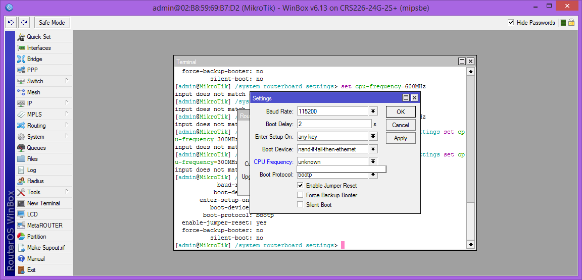

We can not change the frequency of a cpu and the device seems to be performing very poor as the cpu load under 25mbit of trafic rises up to 40% whith all the firewall rules and conn.track disabled and cpu load being rarely below 15% while the device is completely idle.
We tried to change cpu frequency in dozens of ways, also tried to reset device’s configuration. Nothing helped.
Please take a look at the picture.
Thanks. Looking forward for your help :slight_smile:

For change CPU frequency, use serial port and set it on BIOS.
