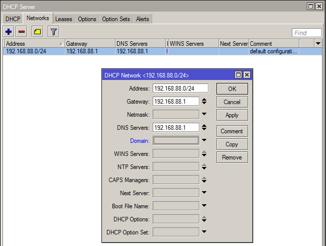

Quickset may not update the DHCP server configuration (it should, of course, but since I don’t use it, I’m not familiar with its quirks) so go check the IP Pool / DHCP Server->Networks configurations to make sure those are correct for the new LAN IP range.
If it happens after the lease thing, then again, you should be able to use a static IP on your PC to get back in and look around to see what’s wrong.
Go to this window and make sure the address, gateway, and DNS servers are correct for your LAN IP range.
In this example, the Mikrotik is going to assign itself as the DNS server, but you could just as easily put 8.8.8.8 and 8.8.4.4 in there…
All of those other fields that are blank in the screenshot can be left blank in yours too.
To change the lease time, switch to the main DHCP tab under DHCP Server, and edit the server’s configuration - that’s where the Lease Time is set.
Also note the name of the Address Pool it’s pulling from…
Make sure that the IP pool is properly configured by going into the IP > Pools menu and editing whichever pool is named in the previous screen.
