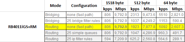

Also I am looking at RB4011iGS+RM as a replacement for the Asus router as an upstream router. Am I looking at the test results correctly when I say it achieves close to line speed without acting as a firewall?
