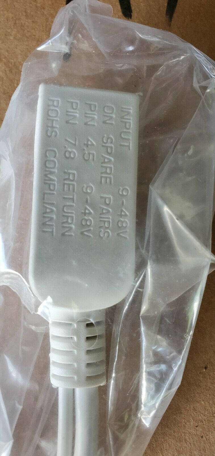

And in looking at the Mikrotik injectors more closely I think that voltage drop is the reason it says 18v on the low end in a few specs. The product description for the old model said that 18v is recommended lower threshold (9v is spec minimum) to account for voltage drop on the wires.
Looking at photos of the new adapter and I can see 9-48v is stamped on it. So I think they are saying 18v in some places for the same reason.
EDIT: this may not be the newest version I now realize (based on color scheme). I ordered 2 qty of “RBGPOE” but it did not show current color scheme so I am unsure what I will get. In any case, whichever comes, I think (hope) it will work since it is just passing through. Voltage drop should not be an issue in my case since I am using a tiny cable, just to benefit from a third power source input. I just happens that I have exactly 3 sources so it is convenient to use the built in switching instead of rigging up my own.

I didn’t have a chance to try the new one with 12V today, but the old one (like on your photo) was ok to power RB260GS on at least 7-8m from 12V.
