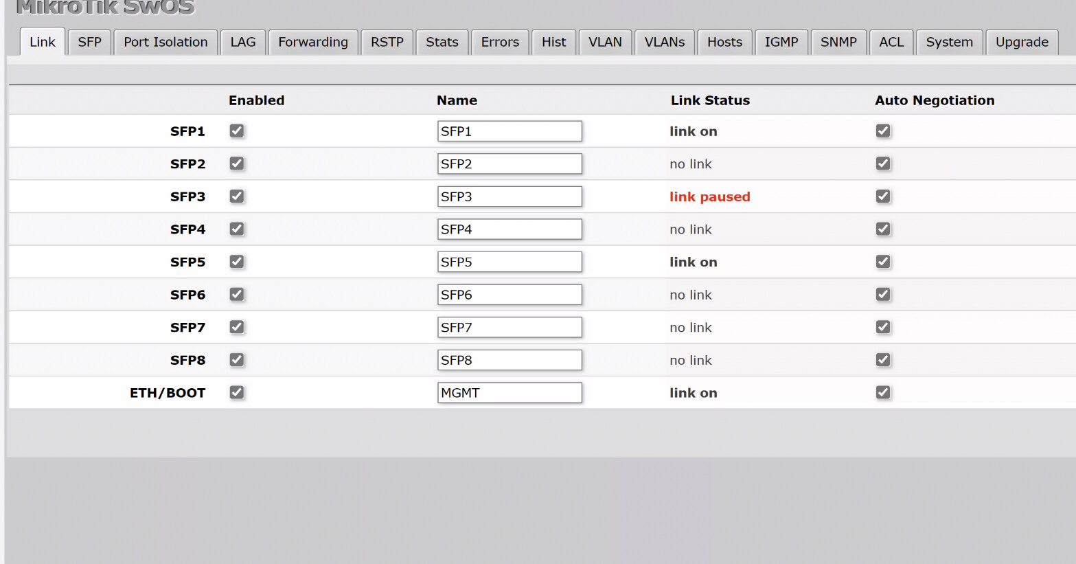

Sometimes the Link to desktop is paused as seen from SwOS.
What I am doing wrong or is this Mikrotik broken? Or is the all other 4 NICs broken but Mikrotik is fine?

Link paused

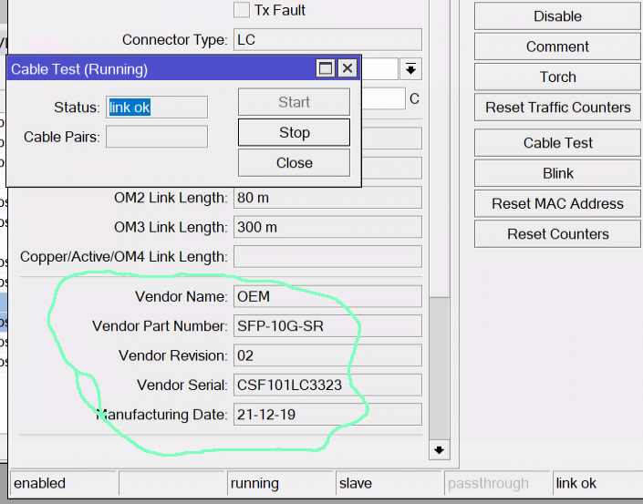

Which SFP+ modules are you using? Support for different SFP modules in MT devices is far from ideal, some modules work much better than others.

Mikrotik ones S+RJ10. Docs say they can use up to 30 Meters of cable which is about 100 feet, and I don’t think it’s longer than that. Probably half that size.
I don’t know what else to think, but we will check the cables next and make sure that’s not it.
Another caveat: due to required high Tx power, these modules tend to run quite hot (MT’s own seems to be one of hottest) … if cooling is not adequate (with most passively cooled devices, such as CRS309-1G-8S+IN, this is the case), then modules may overheat and throttle down Tx power (and consequently data rate). Mikrotik has a guidance on that. If I’m decoding screenshots of your config correctly, you’re already following the guidance … but that might not be enough.
Yeah they’re kind of spaced out, but also not really being used since I can’t get it to work :slight_smile:
