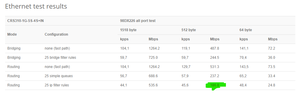

I purchased the CRS310-8G-2S±IN but am only getting around 500Mbit/s internet/WAN throughput when connected to my cable modem using a dhcp lease. I was expecting more given it’s all 2.5/10 gigabit ports but I may not have set up the device properly. I am using a basic WAN on eth1 and then PCs on the other ports that are bridged together. The firewall walls are basic pulled from public sources with fasttrack enabled. I get much faster internet performance on my cheap TP Link Wifi “router.”
Is 500Mbit the expected maximum performance for the CRS310? Any pointers or guides on how to optimally configure it to get faster throughput to the internet is appreciated in advance.
You should have bought something else. CRSes are switches first, not routers, even if they can do routing. With the advent of L3 hardware offload they can route at wirespeed, but not all can also do L3 offload for NAT and firewalling, and the CRS310 can’t.
Looking at the test results, 500M is about as good as it’s going to get in software.
