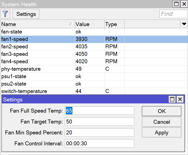

Have you set the fans?

yes, the fans can be a bit loud, i replaced them with Noctua fans for home use and that works fine.
