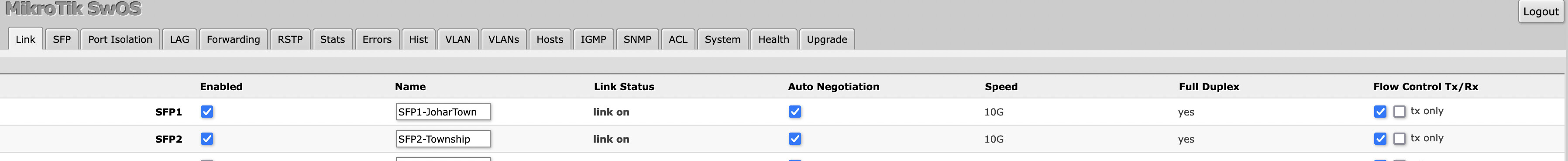

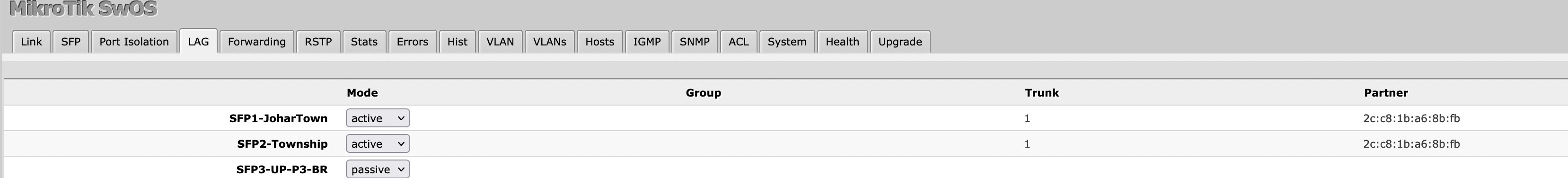

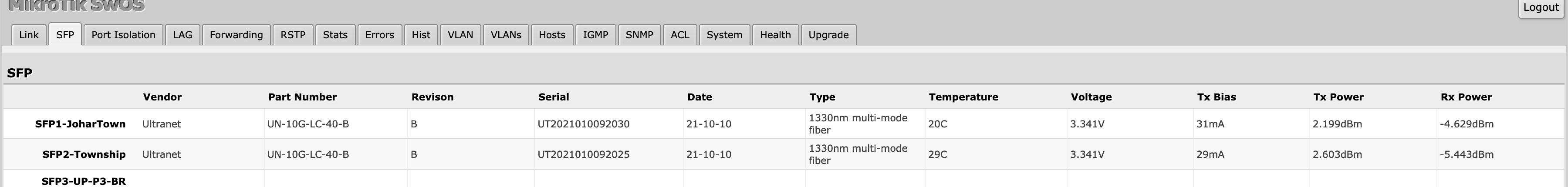

Issue seems to be back. This is not a VLAN issue. Attached are my configs, since there is no CLI, so only screenshots are attached. I am still failing to understand if this is switch issue or something wrong with the LAG.

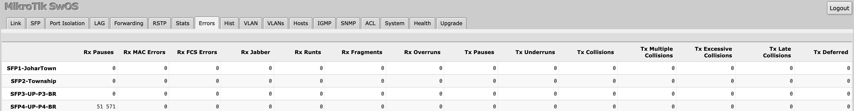

1.- You got lots of rx pauses in sfp4 port. What is in that port? does it work at 10gbps or at 1gbps
2.- You got only tx flow control, I think it should be configured in both tx and rx but I can be wrong.
From (1): Is it posible that whith that number of pauses you lost packets.

Those rx pauses are for some other port. It’s a 10G uplink for Broacde switch, but I have enabled both rx/tx on both LAG ports but still seeing packet loss.

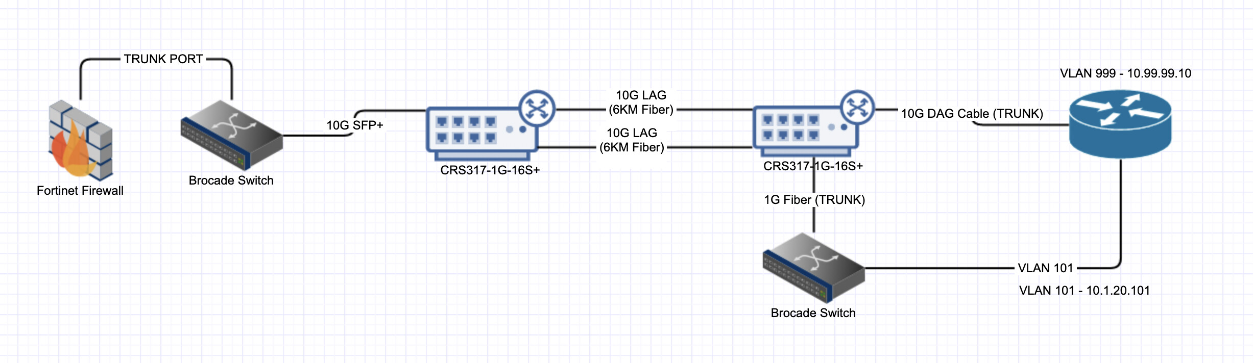

I think diagrams can help understand the problem (L2 and L3 needed)
Also you post only partial data, no both switches data.
Source ip and destination ip of traffic with losts pings.
Best Regards,
Diego
It’s a simple network, I am pinging from the firewall on the left side and the firewall is connected to Brocade which has an 10G uplink to CCS. My port utilization is around 150 Mbps average.

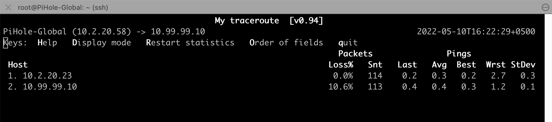

With both links ON, I see the the following packet loss on the router which is direct connect to my firewall.
10.2.20.23 is the firewall which has direct VLAN interface 999 as well. When I turn off any of the 10G link from the LAG, I don’t see any of these packet loss. Both of the CCS have identical config except the right side has router connected and left side has switch->Firewall.
You’re doing well to run 10Gb/s over a 6KM multi-mode fiber - but maybe the technology has improved from what I am used to. However that does not seem to be the issue.
