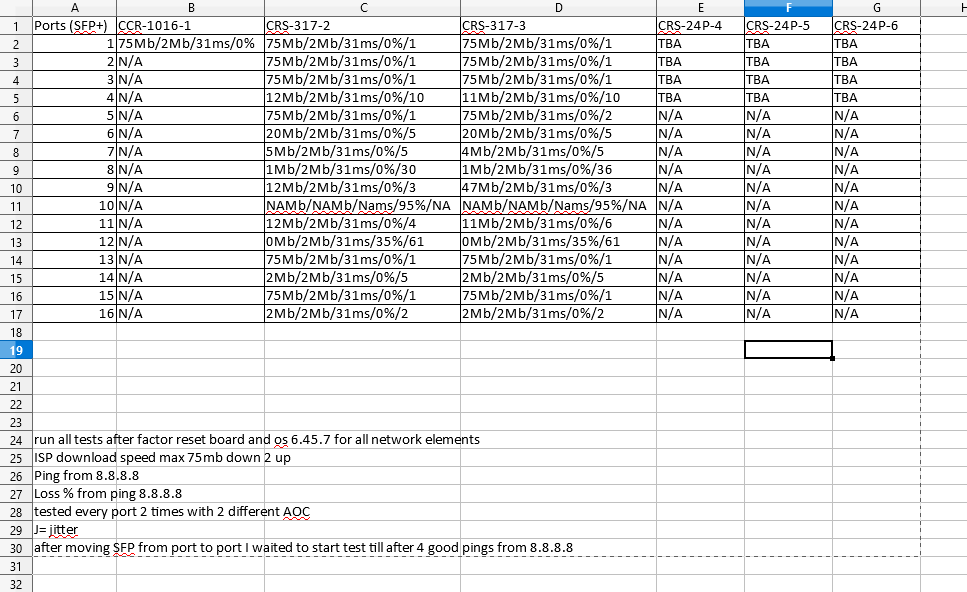

Testing through put off network to ISP speed server and Ping tests to google dns plus pinging CRS and CCR. most ports with low speed have 100-300ms ping and heave loss. Ports with full speed lowing 1ms and full speed
CRS number 1:
CRS port 1 as WAN or root and 2-16 as LAN
Ports 1,2,3,5,6,15 full speed no loss
ports 4,10,12 high package loss
ports 7,/,9,11,13,14,16 low speed 1-22m

I achieved these test results by using the same SFP the same client same computer on all ports between 2 and 16
I originally anticipated it was a hardware issue so I bought a second crs317 but this time the issues are present on most of the same ports will post detail test results soon. I’ve also retested this with multiple isps and multiple SFP and received the same results.
Issues present across 2 separate CRS-317-1G-16S+
