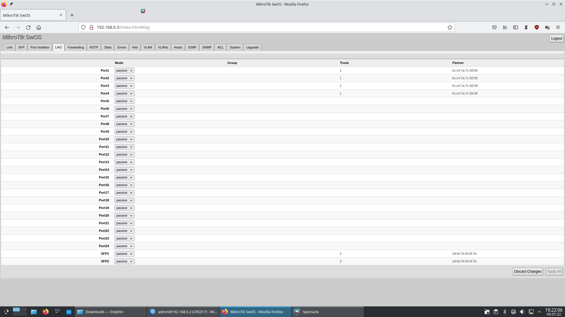

I have a CRS317 as my core switch at home. Additionally there are two CS326s connected via bonding interfaces on ports 1,2 (850nm transceivers) and 15,16 (0,5m DAC) respectively.
The CRS317 bonds are configured to use LACP and the CSS326s are in passive LAG mode.
After some time there always seems to be a hiccup between the CRS317 and the CSS326 connected via bonding2(15,16) as traffic stops forwarding on some ports until one of the units is rebooted.

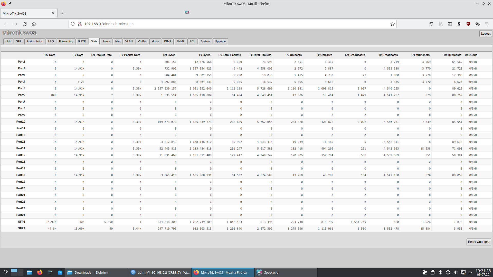

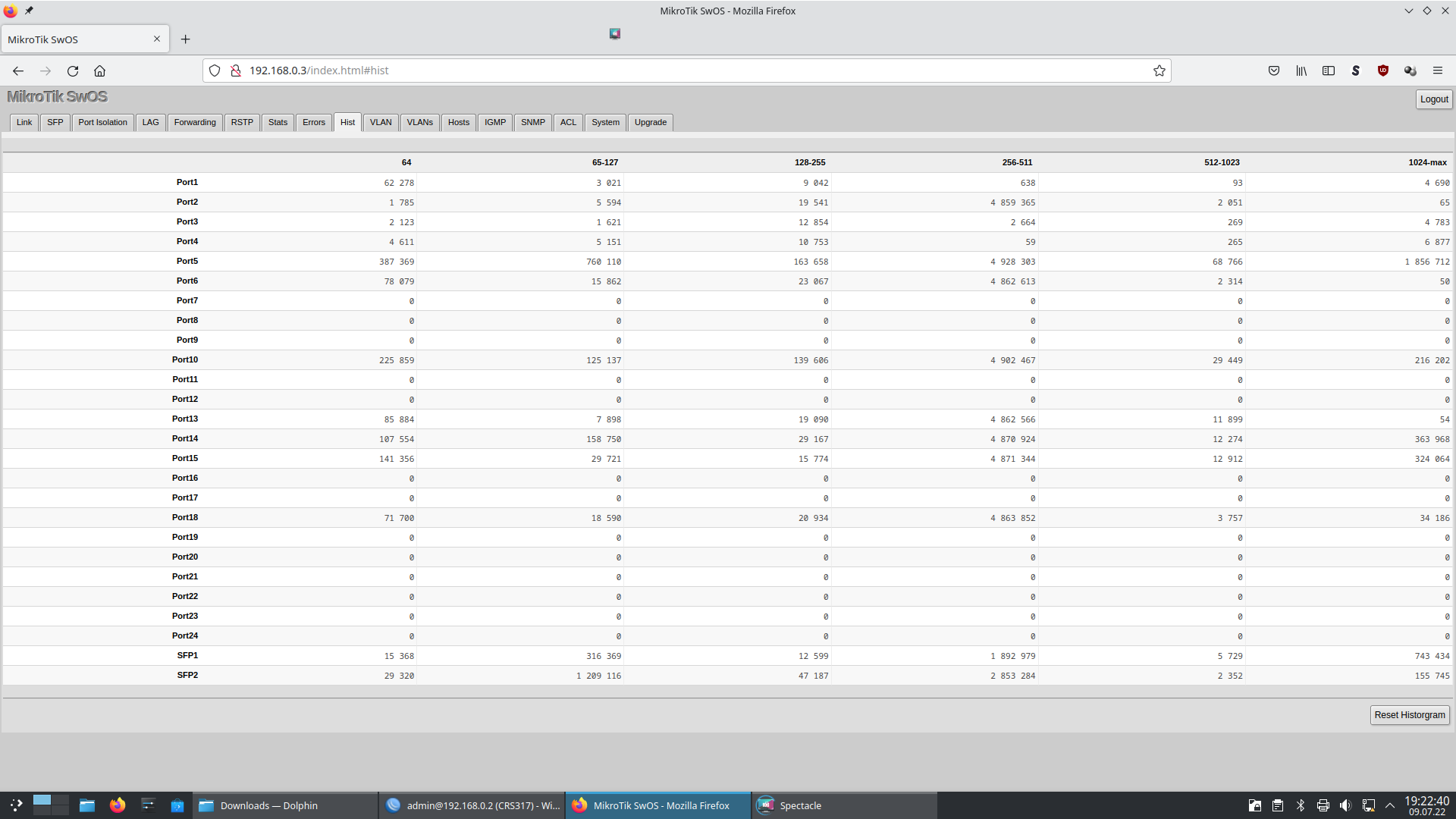

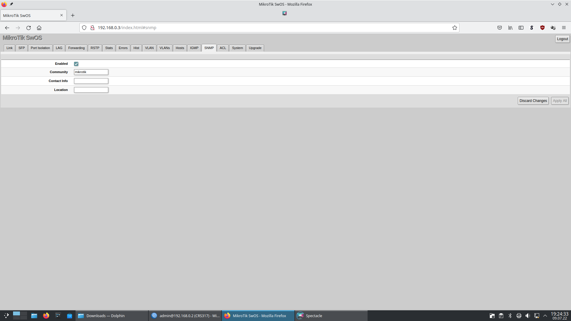

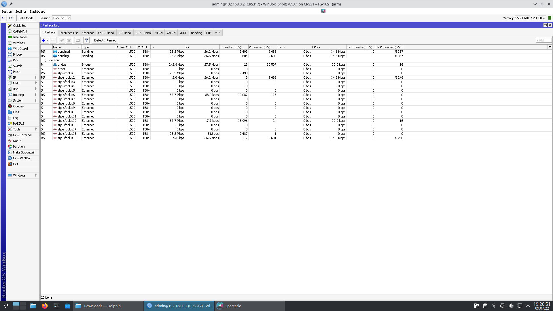

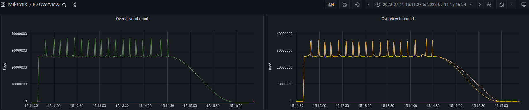

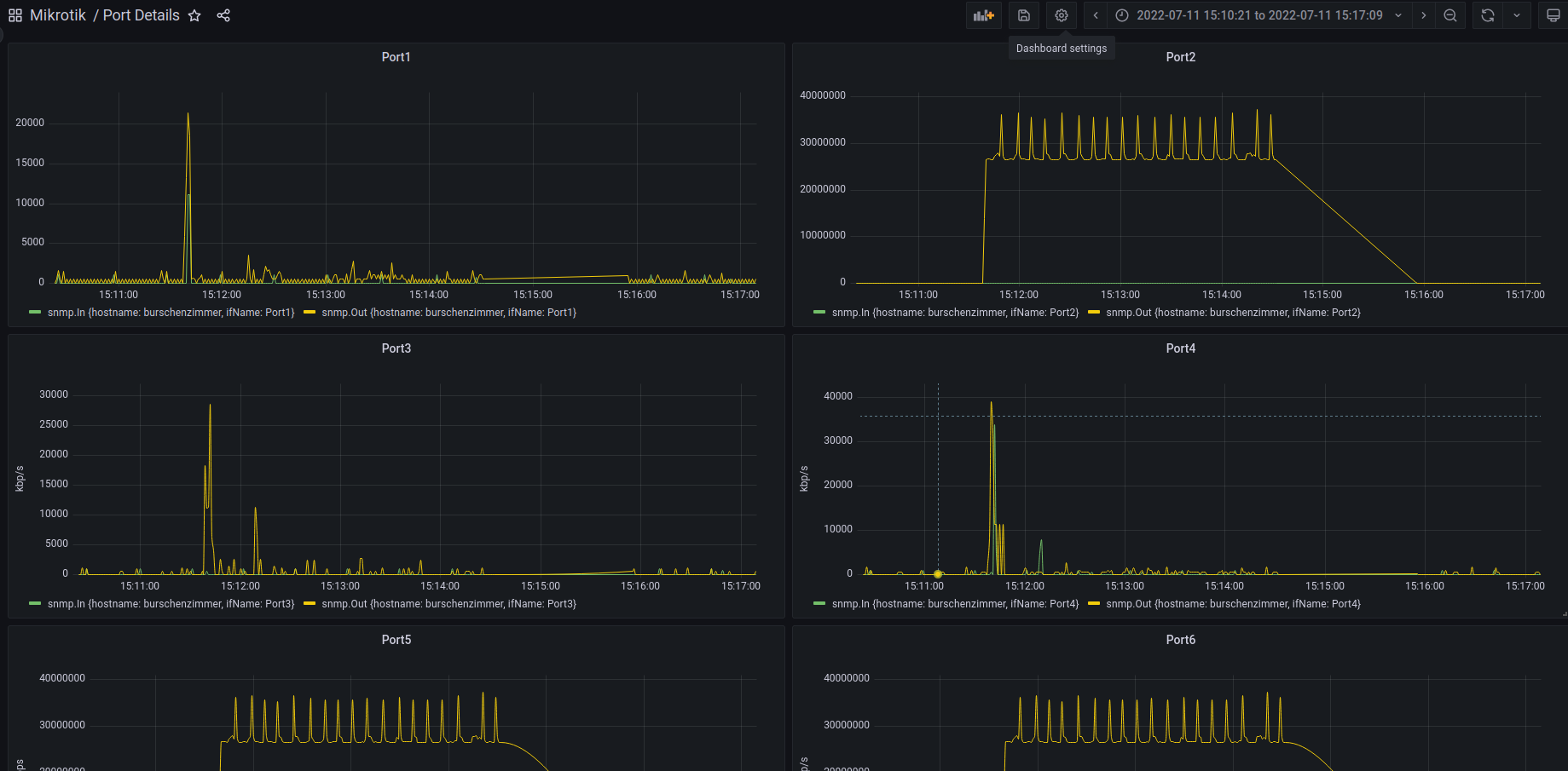

After setting up crude SNMP/Grafana monitoring on the CSS326 yesterday I was able to graph the issue:

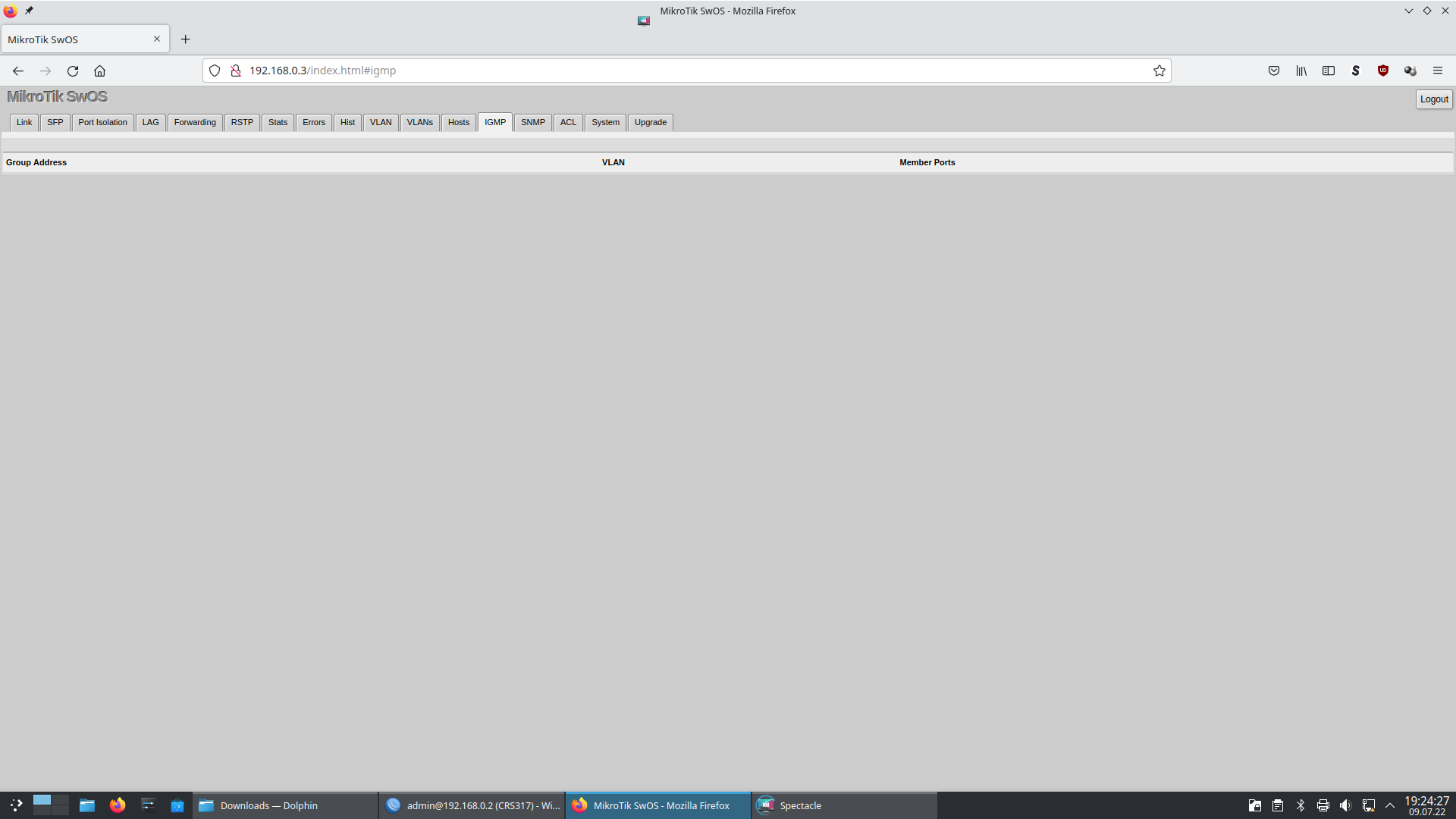

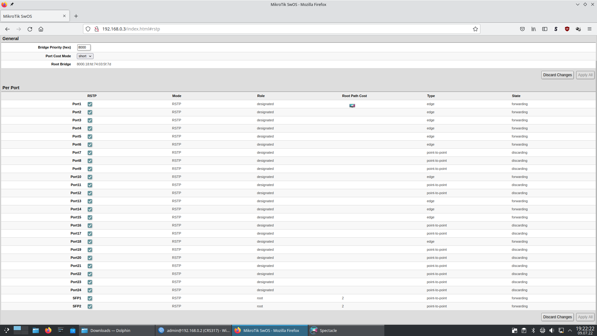

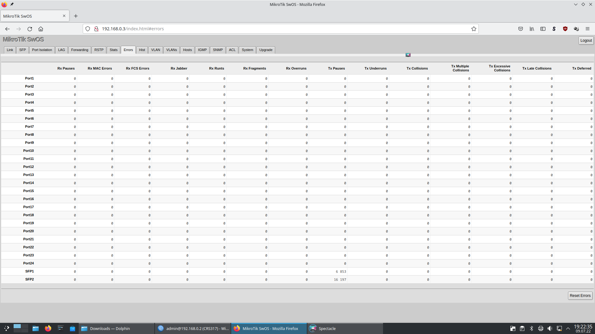

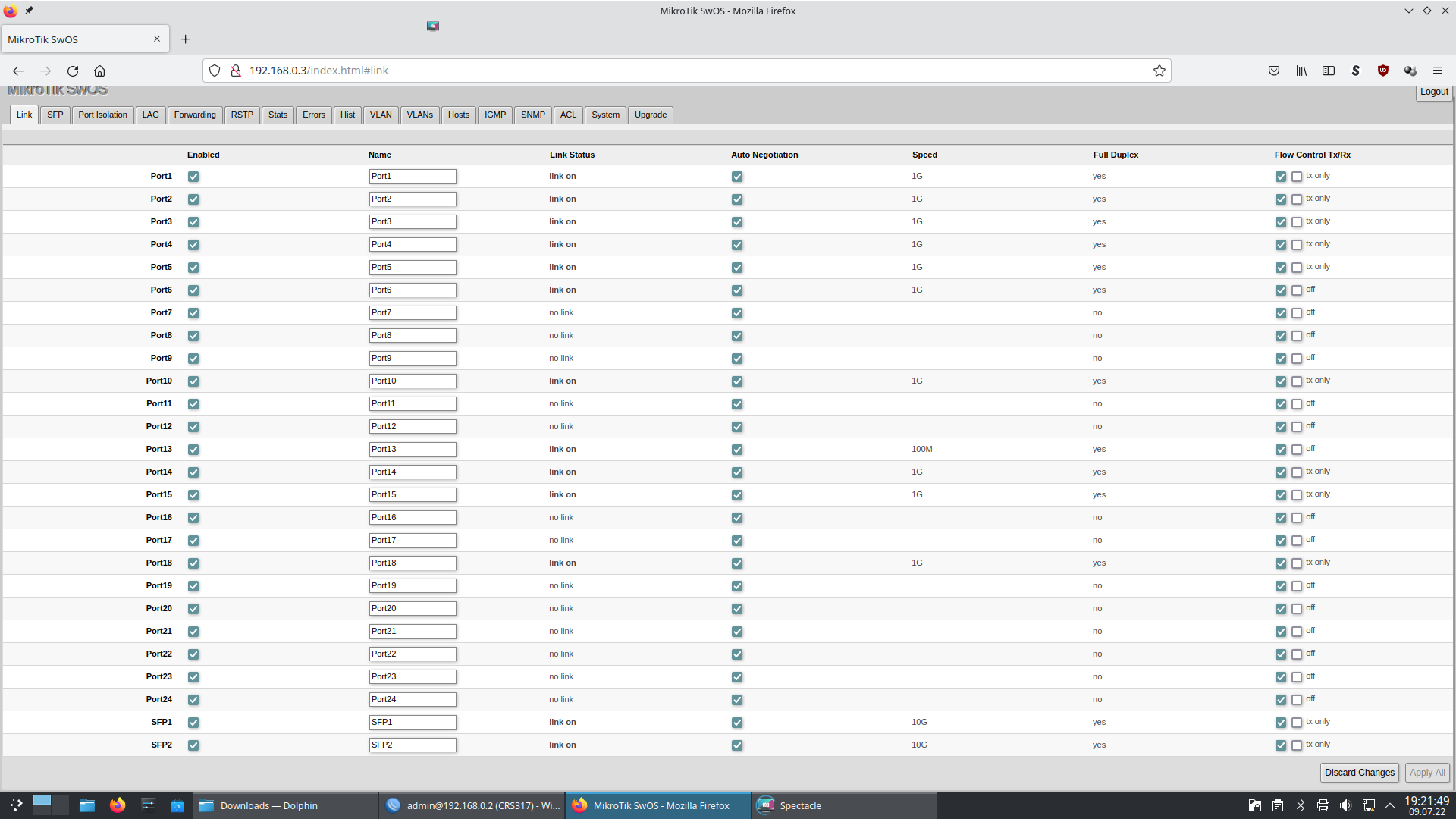

Besides SFP1 and 2 the following ports on the CSS326 are affected: 2 5 6 13 14 15 18. 1 and 3 seem to work normally.

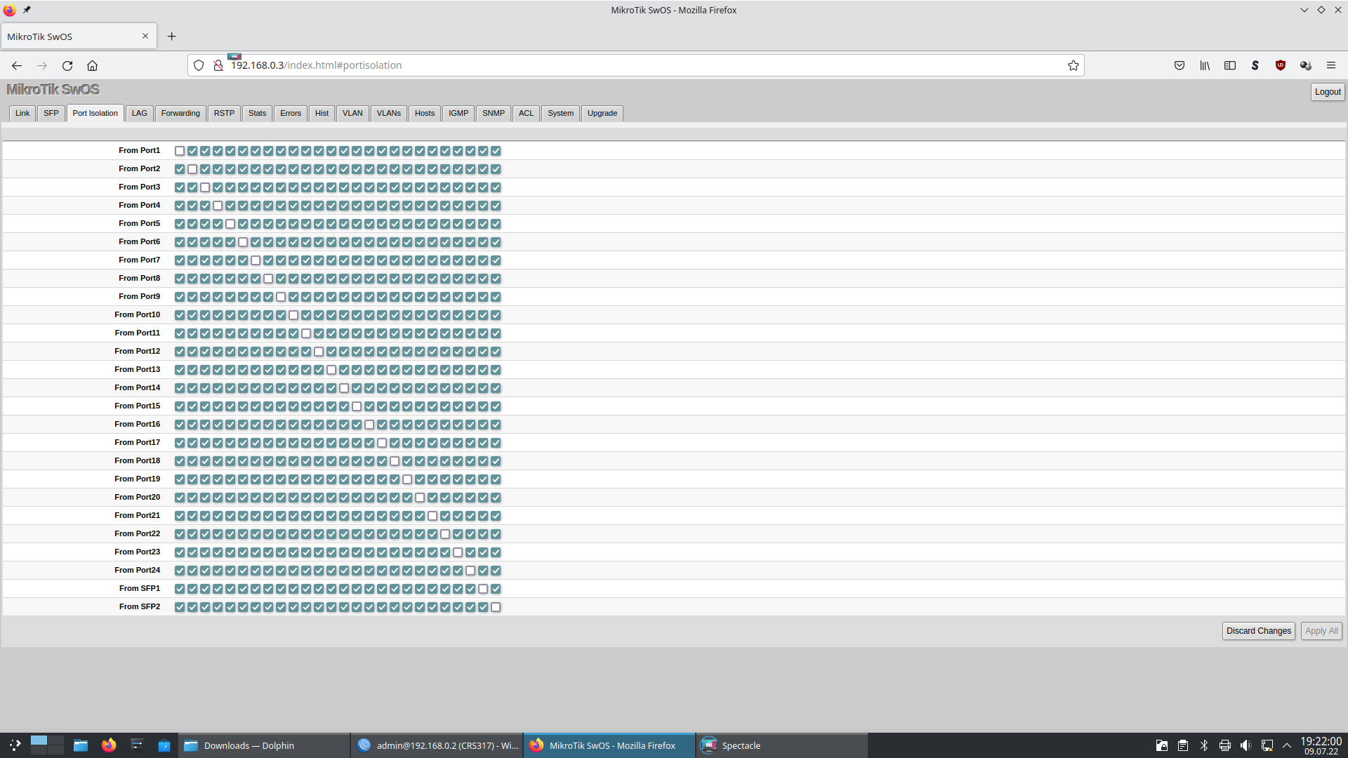

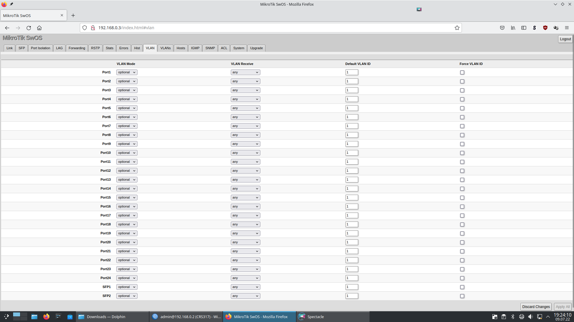

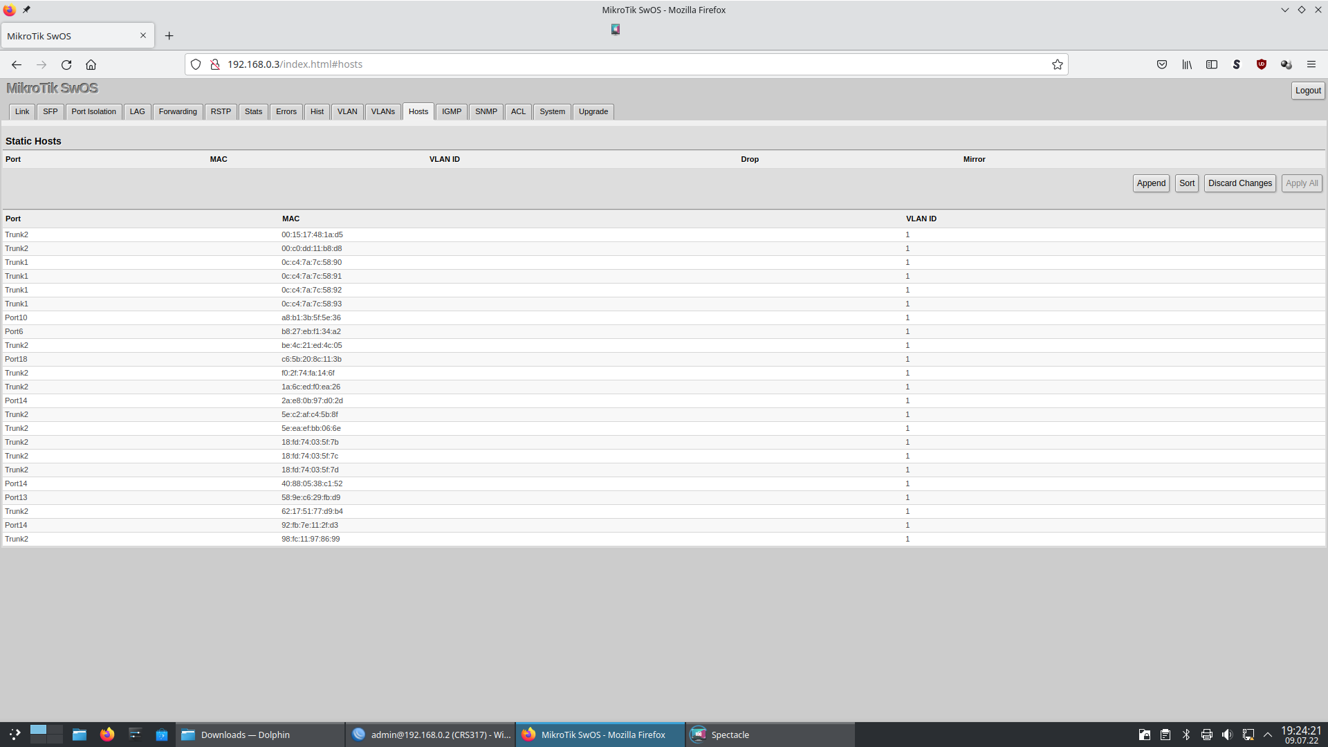

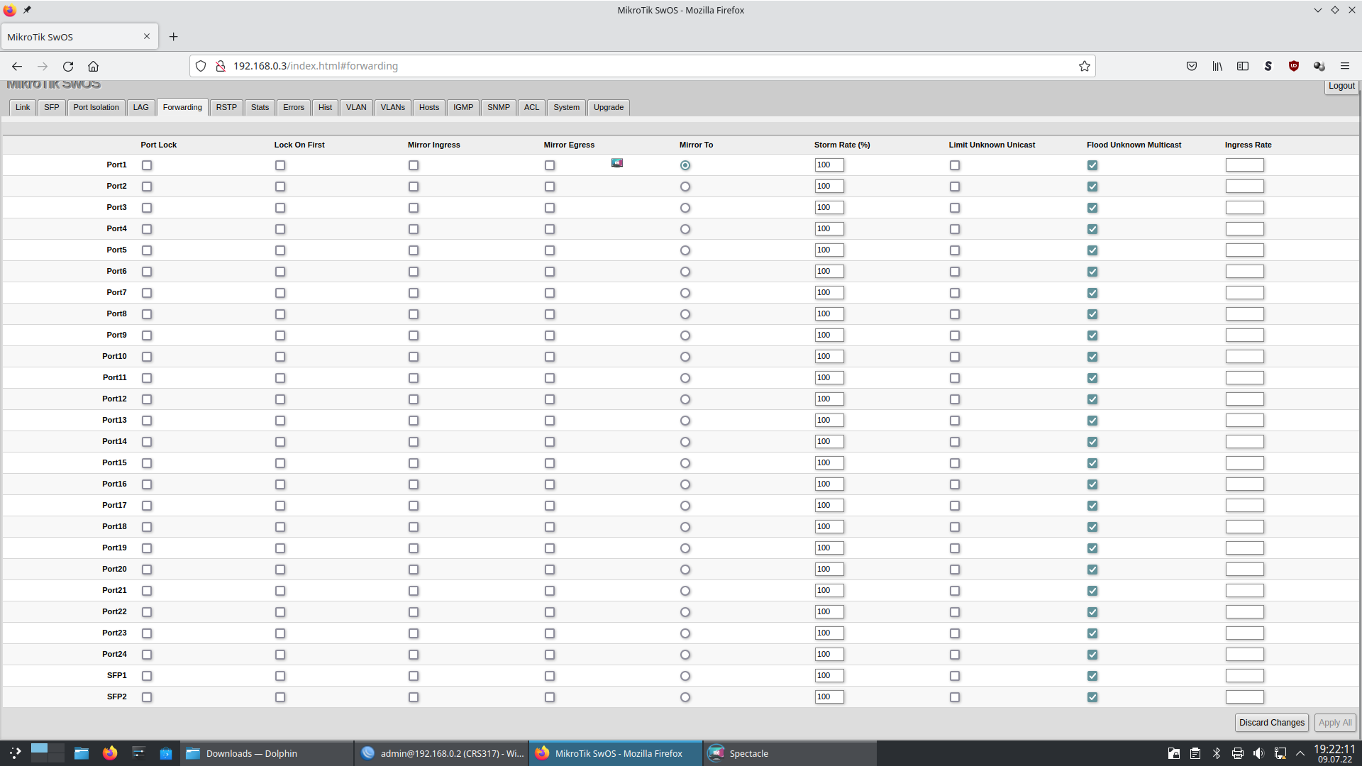

I will also attach the CSS326 config / stats as screenshots and the CRS317 config as text below
I have three supout.rif files at hand at the moment. One during a hang. One immediately after the first one was created because the cpu usage remained constantly at 95% for 5 minutes until I rebooted the CSS326 and the last one created after the watchdog timer was triggered today.

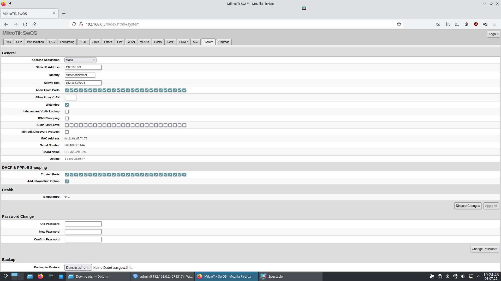

After narrowing down the issue (tcpdump to the rescue) it turned out to be a DHCP packet flood.
According to Support (SUP-86916) this is a confirmed bug in SwOS:
The problem is related to LAG and DHCP packet handling with enabled Add Information Option. The switch might flood these packets and cause a broadcast storm.
Disabling “Add Information Option” under the “System” tab of SwOS is a suitable workaround for me. Hopefully a complete fix will be released soon.
