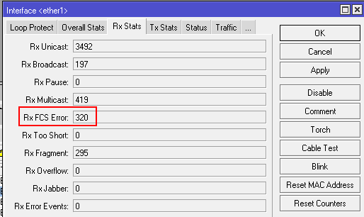

I confirm it but with MGMT port.
If i connect to MGMT port in 100BASE-T mode i see many FCS (CRC) errors on both sides of this copper link.
Trying to change ports settings (advertising modes, flow control, negotiation on/off) do not solve the issue.
But if i change mode to 1000BASE-T or 10BASE-T the connection starts working fine, without any errors/packet loss.
Could the Mikrotik comment on this issue?

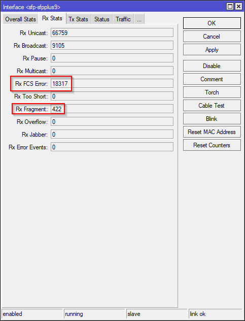

i can confirm the mentioned problem with the CRS317. i have about 3 devices which permanently report many Rx FCS errors when connected directly to a modulport. among others an Auerswald 5020 IP PBX.
a try out of various settings regarding Auto Negotiation / manual setting did not bring any success.
If I hang the devices that throw the errors on my DrayTek 2860 router everything is OK. Also, if I connect an unmanaged switch to the port and the fault-producing device(s) is/are connected to it, everything is faultless, but this can’t be the solution.
A solution of the described problem would be really great
