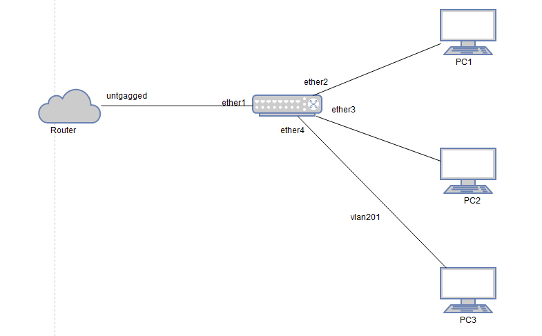

Create a network diagram with your network topology and the VLANs that will be used.
On your diagram note the Trunk and Access ports …
It will help understand better what you want to achieve…
On PC3 is only VLAN201 possible (no untagged). PC3 should communicate with PC1,PC2 and Router

For OP’s case (judging from the network topology chart he posted) the problems with VLAN interface as bridge port will not happen. Ditto for the bridge PVID … it was my suggestion based on my understanding if OP’s problem, perhaps not the most by-the-book one, but would surely get work done. So Zacharias, if you have concrete doubts about my solution to OP’s problem, discuss that.

To Christian,
So the router sends traffic down WHICH SUBNET to the switch?
Does the router provide DHCP for all the subnets?
What is the switches function?
What are your expectation for the switch to do with the traffic
a. coming from the router
b. going to PC1
c. going to PC2
d. going to PC3
e. Why do you want PC3 on its own VLAN.
f. IS the switch supposed to provide the VLAN and DHCP for PC3
g. if PC1 PC2 and PC3 are supposed to see each other, why have the VLAN??
