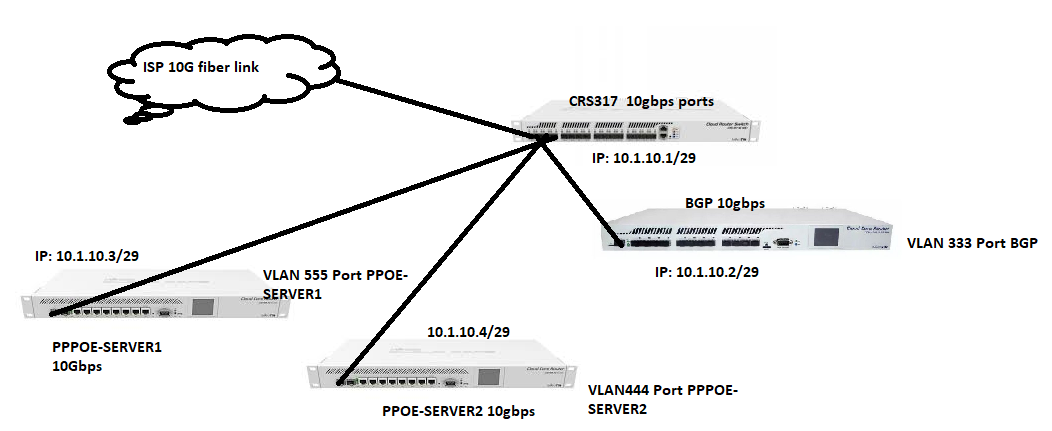

Por1 = 10G sfp+ port that comes from main ISP provider with 10g Internet connection
Port2 = 10G sfp+ that goes into the CCR1016 port1 also (this is our BGP running device with our ipv4/ipv6 ip block
Port3 = 10g sfp+ connected to ccr1009 10g port also (this is our pppoe-server1 device , where we share ipv4 public ip to our clients on pppoe-server)
port4 = 10g sfp+ connected to another ccr1009 10g port also (this is our second pppoe-server2 device, where we share ipv4/ipv6 to some other clients also)
port5 = 10g sfp+ connected to ookla speedtest server 10g intel 520xda1 server also running 10g
Now i need to trunk this in order so i can receive 10G internet link from main ISP provider in port1, and forward traffic to Port2 (BGP machine), and then re-route forward to port3 and port4 pppoe-servers machines, and vice-versa when outgoing connections going out from port3 and port4 to the internet.

Hi Guys
going further a litle bit on the configuration, this is a litle scenario diagram below..
i just need to trunk port BGP with specific VLAN, and PPPOE-SERVERS with another different vlan , but need the BGP to receive all vlans, not shure if this would be the correct configuration
