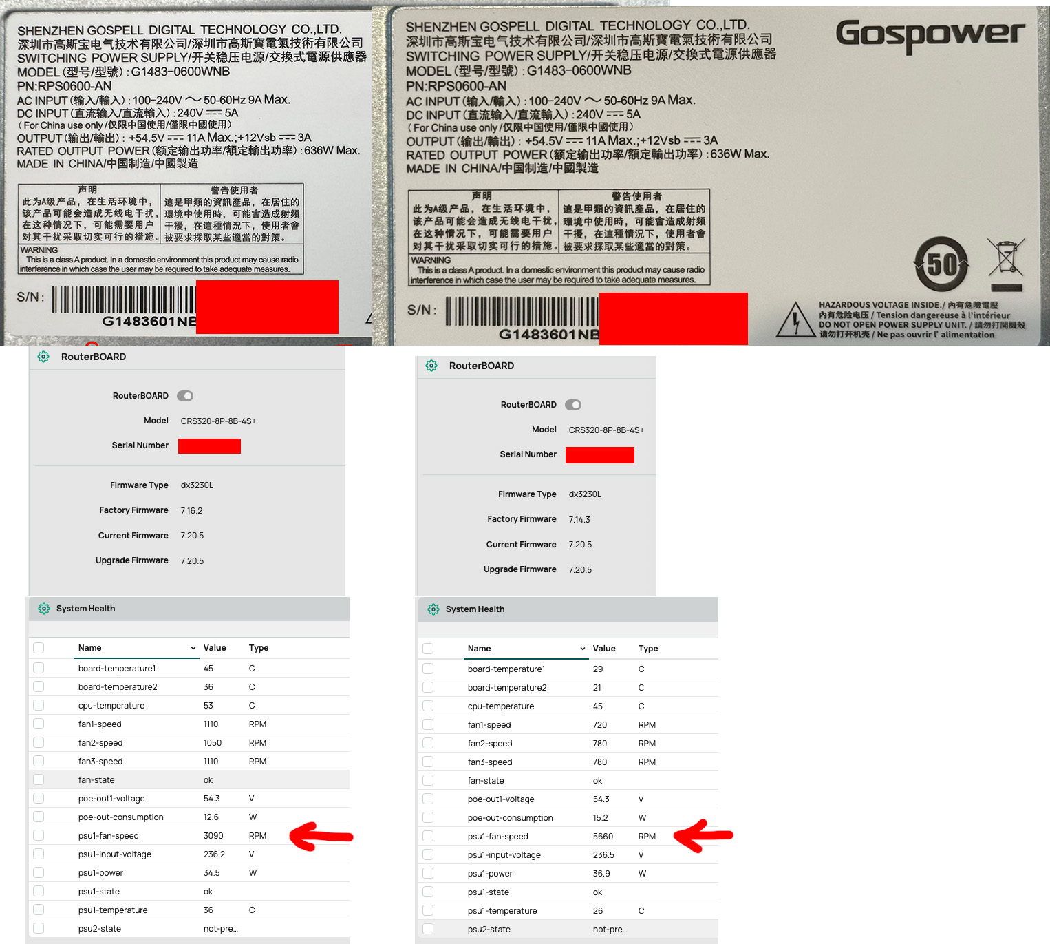

I have 2 equal switches, the psu looks the same but the psu1-fan-speed of one doubles the speed of the other

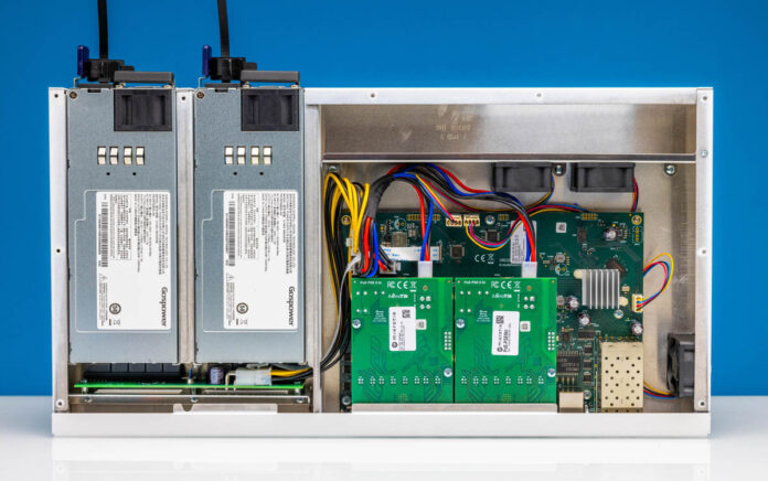

Given specifically the CRS320 layout I would concur:
https://www.servethehome.com/wp-content/uploads/2024/08/MikroTik-CRS320-8P-8B-4SRM-Internal-Overview-696x436.jpg
the psu(s) is/are physically separated by a metal baffle (or partition) from the area where the CPU, other chips and SFP cages are.
Cannot say for sure how fans are enumerated, but presumably fan1 and fan2 are the ones at the back and fan3 is the one on the side (likely specifically added to cool the SFP cages when one or more little stoves are inserted into them).
Anyway I believe that PSU fan speed is "outside" of what RouterOS can (or could) regulate.
If you are into experimenting, you could try checking which kind of fan is in the psu (three wires, four wires?) and which voltage it uses and see what happens with a "slowing down" resistor like (example only):
https://www.aliexpress.com/item/1005004974264597.html
But - generally speaking - that psu has a lot of "oomph" (600W) in a really tiny space and 40 mm fan really need to go fast to provide some decent airflow.
If you compare it with a common ATX power supply in the same range of power, it is double or triple the volume, and it has usually a 80 mm or 120 mm fan.
Maybe (but it is a loooong shot) a mod could be (since you only have one PSU) to use the space for the redundant one to add a fan (pushing air in, since I believe that the PSU fan is blowing air out).
