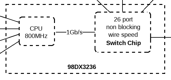

Please help me find Switch-chip description for CRS326-24G-2S+RM.
Microtik Wiki - Manual:Switch Chip Features does not provide information on this platform, such as
As it’s a CRS, i.e. a switch, it has one switch chip.
All ports are connected to this switch chip:
It is possible to combine the ports into 4 independent switch groups, in accordance with the number of links in the picture, or the group can be only one
Don’t think that’s possible, because there’s only one switch chip.
FYI, 6.41RC has a new bridge/switch chip implementation, where hardware offloading is used to accelerate switching/bridging when possible.
Haven’t tested it yet, and don’t know which specific circumstances need to be met for HW offload to kick in, but it may be possible to have 4 bridges and use HW Offload on them.
